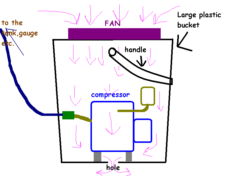

but air cooling & fans work too and that's just less of a hassle... I know it seems surprising but fans really work... just don't expect a wimpy 0.5W fan to do the job really well... you need something more powerful
probably take about a year to fill it
not really, it takes about 10 minutes to fill ~ 9-10L to 100 psi with a fridge compressor... I don't have an AC compressor but it should do it much faster
EDIT
that's what I have in mind.. most of it is already done
air cooling_flow.PNG (25.73 KiB) Viewed 3228 times

I believe that a simple fan can provide good enough cooling to allow to run the compressor continuously...

yeah sorry that 0.5W was just a guess... anyway that's not the point, the point is that you can easily get more powerful fans... 50W or 100W fans do not have to be large
there is not reason to build a cooling system that is so complicated that it costs more than the compressor itself... there are other things that are worth adding in the long run and are more important... like a tank or air filter/oil&water separator

Why not a metal bucket, it will be a radiator fin in its own right.

The bucket does not have any contact with the compressor... I think that high flow will be enough to do the job
Can get four for $20NZD:
http://www.trademe.co.nz/Browse/Listing ... =277561100
Tempting...
Fri Mar 19, 2010 7:02 am
POLAND_SPUD wrote:The bucket does not have any contact with the compressor
Well, it's bolted to it, right?
You could also mount an additional fan at the bottom of the bucket to accelerate the air even further, there are some nice 200mm fans available too ;)
For very little outlay you can get yourself heatsinks and thermal paste (not as expensive as you suggested earlier) to festoon the compressor case with. Overkill, perhaps, but let's face it, if you're using a fridge compressor, you bloody well believe in overkill :D
