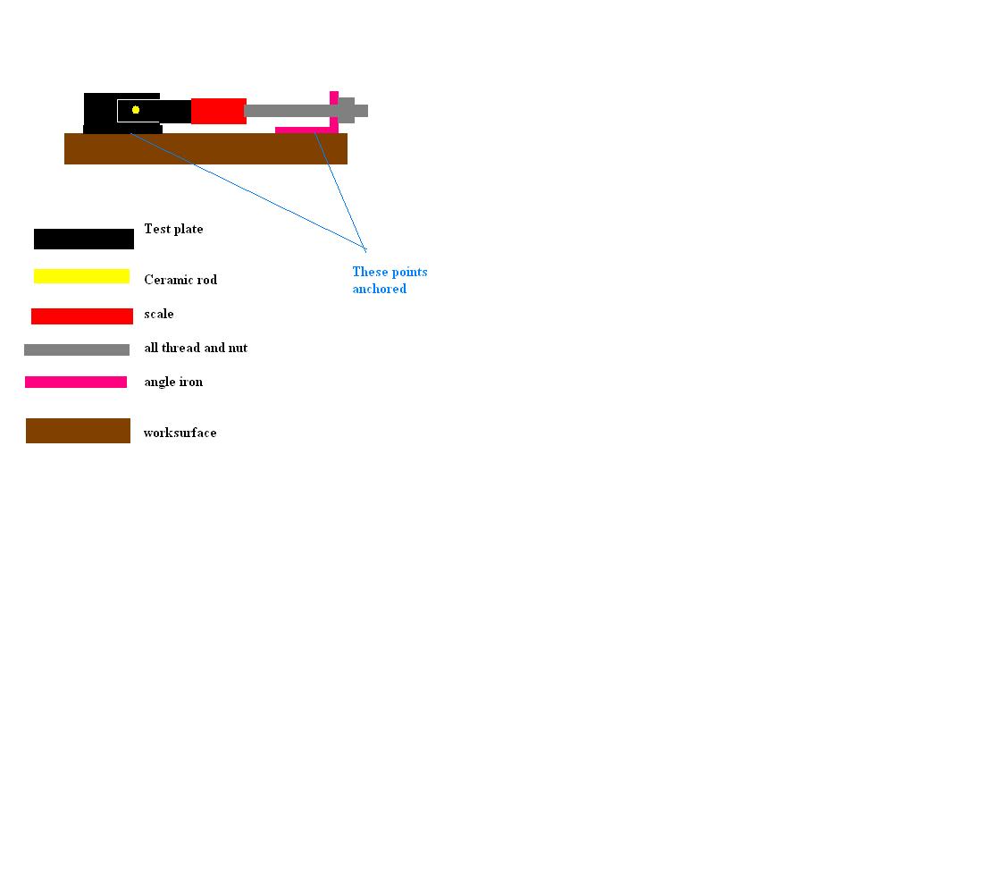

Testing shear strength shouldn’t be too difficult. Two metal plates with a hole the same size as the OD of the tube. Place the plates against each other, anchor one plate. On the other plate get a big fish scale and some threaded rod. Attach the scale to the second plate and connect the all thread to the scale, and then you need a piece of angle iron with a hole in it. Put the all thread though this hole; tighten a nut against this plate to apply tension to the setup. Video the test, specifically the scale to determine the failure point.
Edit picture added.
Edit picture added.
- test rig.JPG (36.67 KiB) Viewed 2790 times

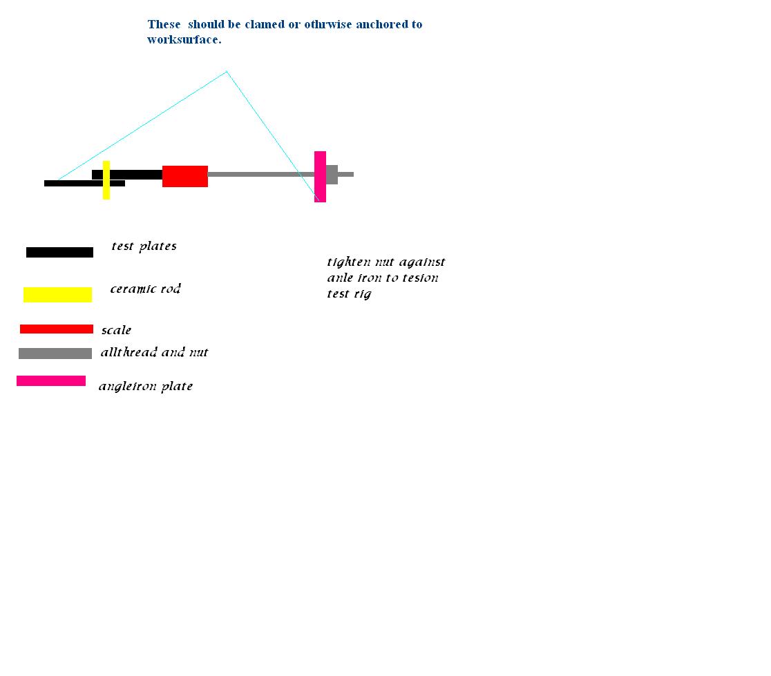

That's the basic idea, but im not sure if it will work. What is the purpose of the spring? How are you going to measure shear strenght? Can the plates slide past each other? The picture I posted was a top view.

I am aware that what I just built needs to be modified to work (Doh!). Unfortunately, no fish scale that I know of can simply be attached to a steel plate and a threaded rod, so that's the spring from one.
EDIT: And that is why I'm waiting until tomorrow to test. I can't think straight at ALL.

This apparatus will now actually test shear strength. Yay! I'll probably have a number tomorrow.

I'm about 3d from the end so I think I'll be okay on tear out stress.
Results from first trial: No break under 22.87 pounds (edited because I can't read a ruler
), so making the assumption that pinning entirely through both sides will distribute the load over twice the area of the area and double the yield strength, I have an approximate safety factor of 2.33.
EDIT: Found the original design to be ineffective, so here is what I'm using now:
No idea how I got the first result, later trials with version 1 showed a break at 13.09 pounds, but the square bar stock was tilted significantly under the load, so I think they were invalid.
Applied a load of about 26.18 pounds, no break, spring nearly fully compressed. Looking into a stronger spring. I really don't mean to blow off calculations here, I'm a big fan of numbers for certain. I simply can't find any data on my particular ceramic.
