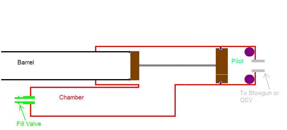

I was wondering If I could use a 3/16'' aluminum rod in a piston valve. I already have the rod from a previous project and it would be MUCH lighter than a solid piston. I'm looking at 2'' because i have a 1.5'' chamber and 1'' barrel and it would give me some wiggle room on size. BTW the check valve was out on the wrong design.
EDIT: I corrected the image
The CORRECTED version

That's really thin for a 2" valve... I used 5/16 threaded rod in my 2 inchers and it is fine, but I'm not sure how much smaller you can go.

Yeah, I DO have a .25'' steel rod but that's ammo for my gun. I guess i can sacrifice 6 or 7 inches of it since it IS 2 feet long.

Your diagram looks good, you might wanna try the threaded rod piston.

3/16 aluminum rod seems a bit flimsy to me for a piston that large. It might work though, you can always try and then replace it if it bends or something.

Gun Freak wrote:Your diagram looks good, you might wanna try the threaded rod piston.
Thanks, I'm going to thread a steel rod I JUST found. It's precisely 0.311'' in diameter and 6.5 long.

All rod bending aside, you need to make sure there is enough bearing surface on the large end of the piston so that it will stay centred and seat properly.
You can also get rid of the bit of "inner" barrel which would give you some more volume and better flow.
Could you not fill from behind the piston ? Just cut a little groove to make the O-ring only let air through in one direction.
