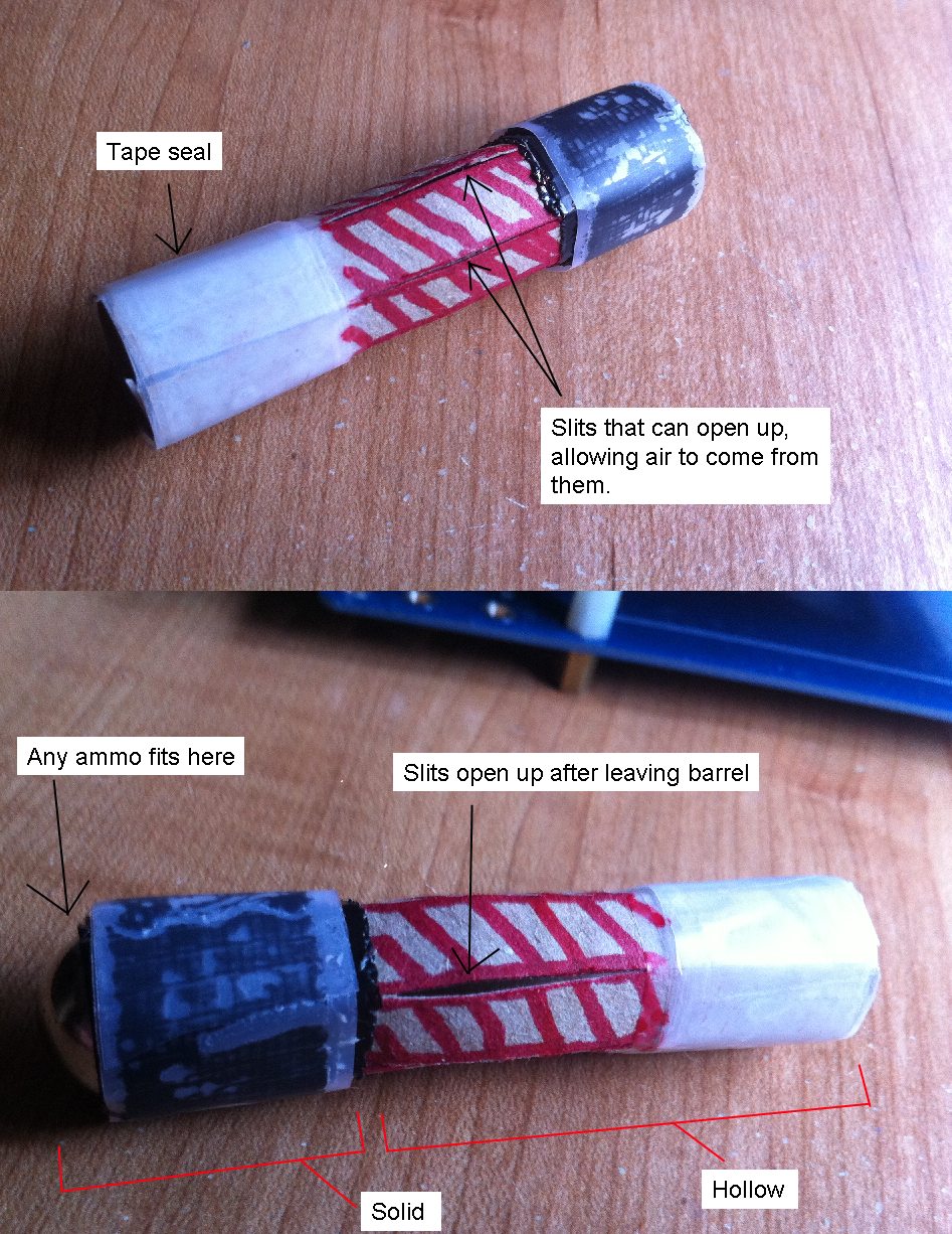

Supressor Round
Pros:
>This round is made up of a solid ammo and a cardboard tube tail, with slits cut in it. It can be made of any semi-flexible sheet rolled into a tube, can be any size. Only needs some tape otherwise.
>When shot, pressure can be released from these slits when the round exits the barrel, suppressing some sound. The tip can actually be just about any ammo as long as it can be attached to this.
>The back end is taped shut to prevent the slits from opening up and causing excessive drag. The suppressor round also helps stabilize rounds like a dart and can have slits cut diagonally to spin the round.
>Better than a suppressor because its not as bulky.
Cons:
>Not very effective as suppressor, only reduces the sharp "crack" sound of some spudguns.
>Labor intensive to make.
>Less performance than other darts.
Cons:

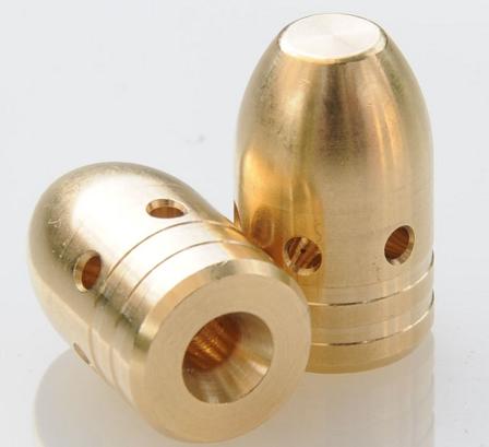

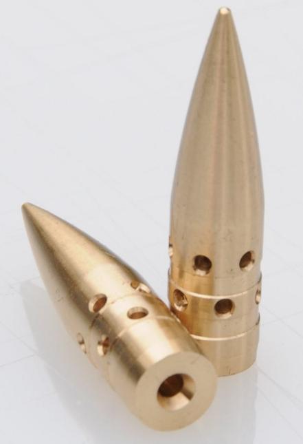

Interesting related development for firearms, not sure how effective it would be in practice.
JSR;
At first glance, I thought you were showing off new parts that you just made with your new machining skills!
Possibly could be redesigned to make a whistling projectile.
