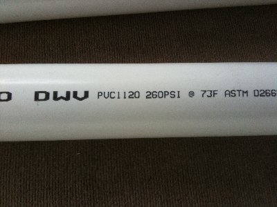

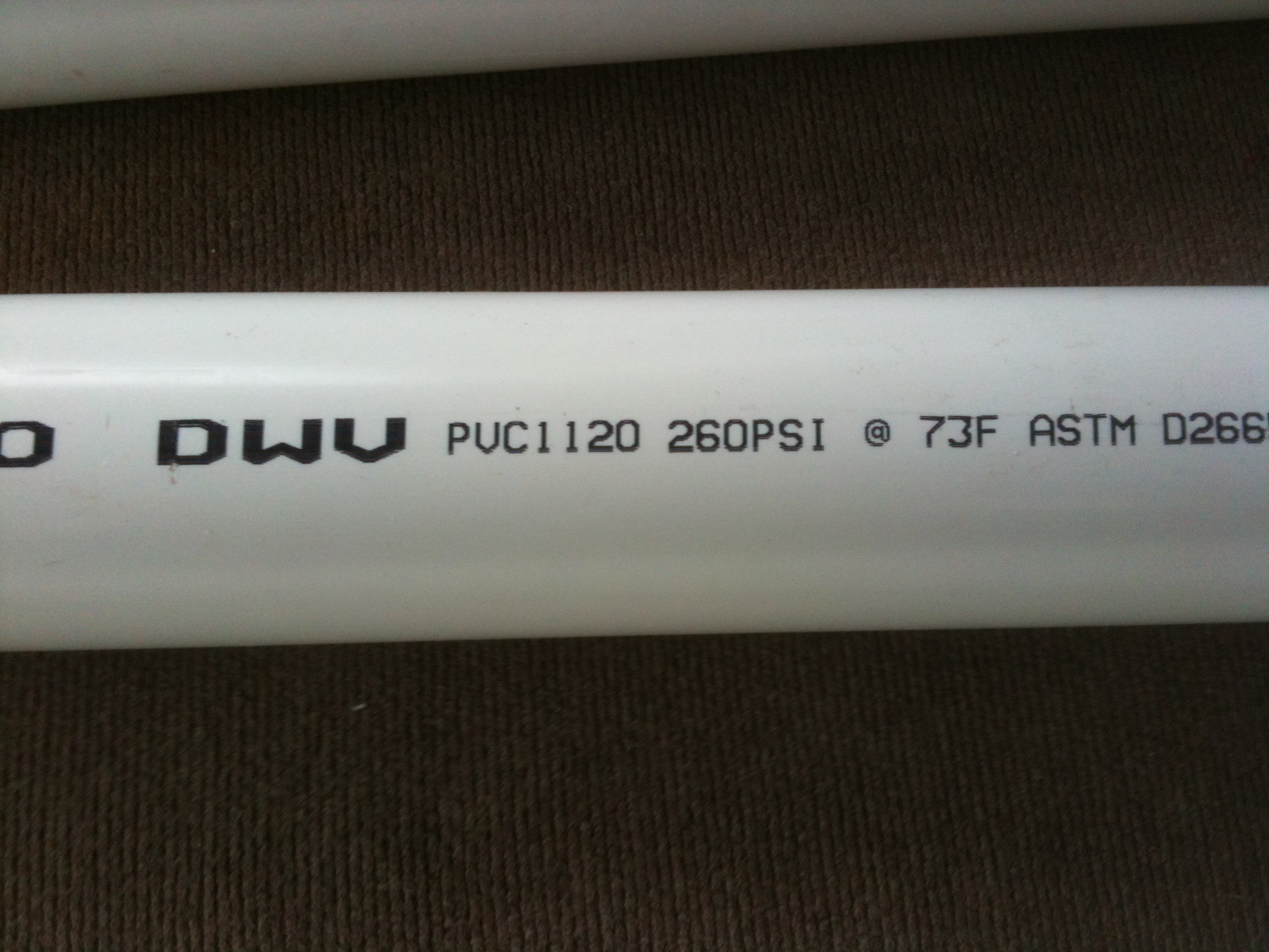

Hey Guys, new member here with a materials question. I'm finally getting started on my first serious pneumatic, a 3" piston valve launcher, and was picking up some PVC when I found this stuff:
[img]
its labeled as both dwv and pressure rated, which doesn't make sense to me, but I assume that it'll be ok to use because its the pressure rating that really matters. I just wanted to check if anyone has experience with this kind of pipe before

3 inch SCH40 PVC pressure rated pipe is rated at 260psi @73 degrees F.Backyard Pneumatic wrote: I'm finally getting started on my first serious pneumatic, a 3" piston valve launcher, and was picking up some PVC when I found this stuff:
Stay with about 100psi maximum and you should be OK.
The reason for the dual rating for DWV is because if it is rated for 260psi it will also work for DWV purposes which a very low pressure.

All pressure rated pipe is also DWV (like dewey said). It is the converse that is not true, all DWV is not pressure rated.
