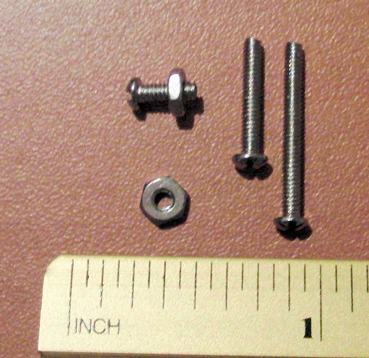

What do you mean you can't find a small bolt?
If you go to a hardware store like Home Depot, you'll find easily small bolts.
Maybe I don't understand. Care for a drawing about what you have in mind?

May I suggest you look again?
This is from Home Depot (or another similar hardware store I don't remember).
And you can find much smaller bolts in hobby stores.

At the hobby store, in particular if they do RC cars / planes, you'll find really really small ones!
At least with diameter 2 times smaller than my picture. I have some... can't find them in my mess :?
