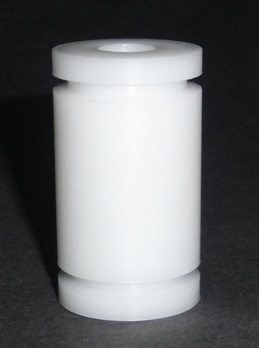

To make mine easy to seat, I added a small mechanical stop on the small cannon so the piston could not be pushed too far forward. Closing the valve properly is as simple as pushing in the knob until it stops.

A bit too fast with my PM, Looks very nice :)
Also a very nice polymer, I may take this up to 500 psi when I get a fridgy, And I definately want something strong :D
Acetal is surprisingly tough stuff, I would definitely trust this at 500 psi. I suggest a 10mm washer to spread the load though.

While it is at your place, Would it be a lot of work to put a slight bevel on the outer edges of the piston?
Sharp outer edges on plastic objects tend to get very ugly :wink:
Not necessary for the O-ring grooves BTW.

Labtecpower wrote:While it is at your place, Would it be a lot of work to put a slight bevel on the outer edges of the piston?
Well i don't want to clamp it in the chuck now and mark the surface, but I'll be careful ;)

Labtecpower wrote:I don't care about some slight marks, I think you have proved to be a good machinist :D
done without marking, thank you masking tape.
