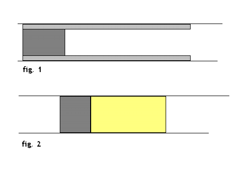

Twitch, if you can't cast lead directly then there are two basic ways to make aerodynamically stable slugs.
The first one works if you have some pipe that fits the barrel exacly (or almost, you can wrap it in duct tape till it's a snug fit) - cut it to about 4 times the calibre, then pack the front (about a calibre's length from the nose) with heavy material (epoxy, lead, plaster, whatever's cheap, sticky and available - note I said it must be heavy :p could also be a mixture, say lead pellets in a plaster matrix).
The second option, similar to a Brenneke type slug, is to have a heavy nose attached to a lighter tail. Nova used this system to good effect with his pimpin' ammo.
