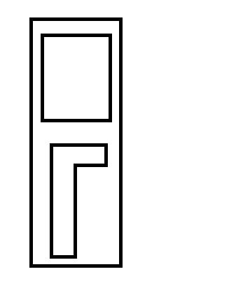

I always use a barrel with a smaller pipe inside of it, then cut the barrel like the picture below. It restricts the airflow just a bit, but it works well.
If you cannot understand that, then there really isn't much else i can tell you, it is pretty self explanitory.
