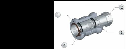

dewey-1
Posts: 1298
Location: NE Wisconsin USA
Thu Jan 31, 2013 11:47 pm
jsefcik wrote:You could probally use any oil , there is no rubber inside correct?
Here is a typical inside view of slide valve. Note the o-rings!

Fri Feb 01, 2013 5:07 pm
I use Gunk silicone grease on my slide valves. I find that grease, as opposed to oil, works best for this application. And you can always count on silicone not to ruin any o-rings.

Sat Feb 02, 2013 12:21 pm
Without rubbers it wouldn't be safe...
I suggest using Lithium grease aswell.
Another option would be Teflon spray.
Don't soak the O-rings as some will suck it up and expand making the valve harder to open.
Silicone spray will be gone in no time..doesn't last.

Sat Feb 02, 2013 3:57 pm
jsefcik wrote:Wasnt sure about what the insides consisted of, as I said in the beginning , there is no rubber inside correct someone could have said there is rubber inside therefore I was wrong
There are o-rings which can deteriorate if you use the wrong oils. We're not making fun of you because you didn't know the internals of a slide valve, it's because you failed to think critically about the design. You know that 99% of valves and stuff here require some sort of rubber for a temporary seal (sealing face, diaphragm, o-rings, etc), yet you couldn't infer that a slide valve would also have some form of rubber that allows it to seal.
