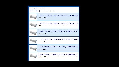

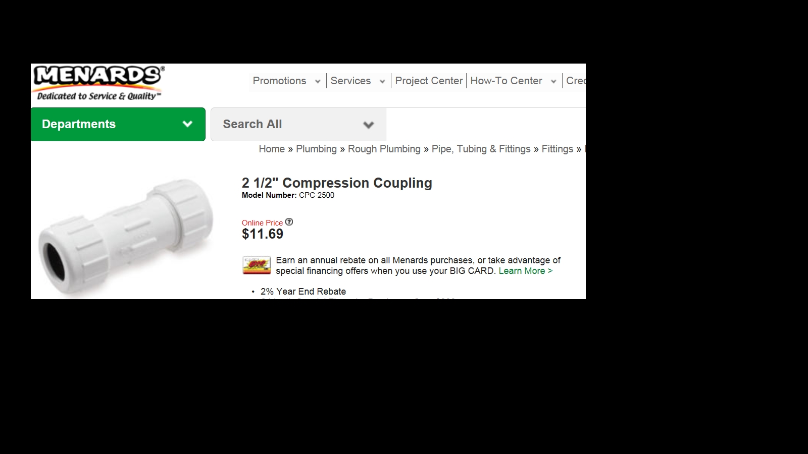

Here is one that is readily available at many DIY stores.
KBI fittings at Menards
LASCO fittings:
brettdotcom14
Posts: 49
Joined: Tue Sep 06, 2005 8:50 pm
Fri Jul 05, 2013 1:52 pm
well no stores by me have 2 1/2 anything but that seems to be the ticket. perfect thanks guys
