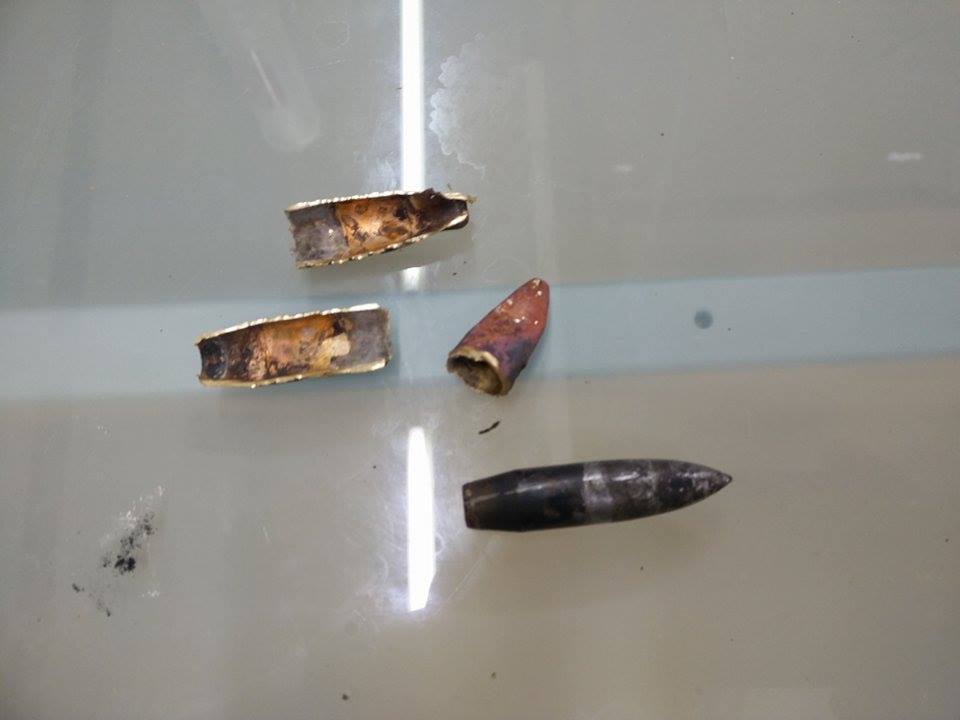

A friend of mine asked me to cut a .50 bmg bullet down the middle for some kind of artsy stuff he was doing. Bout halfway through cutting my blade hit something VERY hard, i ruined almost 2 blades before giving up and using a dremel to cut away the copper jacket to see what was causing my problems... Didn't take me long to find it;
Sooooow, what to do with this? I'd really like to incorporate it into a sabot round for my upcoming cannon :) It's a 30mm cannon so this should work just nicely on a sub-caliber penetrator! But how would one attach this to a stem with fins? I don't think you can just drill and tap into this stuff?

Those look nice! What are the fins made of? If i could make something like that i'd still need to attach it to the penetrator itself, and I'm guessing it's tungsten so how would one attach another metal to that? Edit: I think I've read somewhere that silver soldering might work?
Well, check with a magnet first, as a lot of AP cores are hardened steel (which can still blunt tool blades, after all, they're hardened steel too), but even if it is, it's still got the potential to be a very mean projectile.
... and a little safer too. Tungsten is rather toxic if you prove to be one of the unlucky people who finds a way to get it into your system... and a skin irritant too, but that's less significant.
In any case, if it does prove to be tungsten, treat it with respect. (Although don't worry yourself unduly about previous exposure - if you weren't suffering from nausea, sudden seizures or a coma shortly afterwards, you probably didn't give yourself acute tungsten poisoning).

You could determine what it is by weighing it accurately and determine it's volume by measuring waterdisplacement....Hope it's not uranium...

Well, it's magnetic and it won't scratch glass so I'm guessing it's hardened steel :) But yeah you'd need a truly mighty cannon to really use tungsten to it's full potential right?
I'd say these are more then enough for my humble cannon, and my friend told me he's got like 200 of these bullets! They've already been fired out of a gun by the looks of them.
Just a bit bummed about missing out on a free tungsten cutter for my glass rods! :roll:
