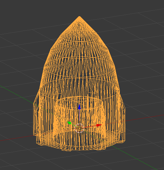

I designed the shot in blender and exported it to cura for slicing before printing.
notice the hollow cavity at the base to make the projectile more top heavy

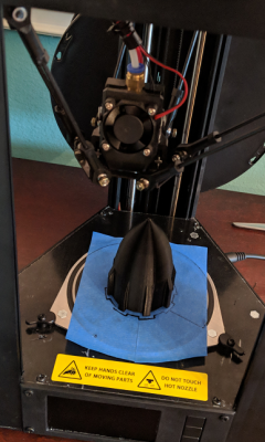

I decided to print with 25% infill so that the shot would be durable but not too expensive filament wise. This made it come out at 31 grams, which is pretty light, but a later version will have a hollow cavity to add some weights. The shot is 51.5mm in diameter so that it fits nicely in 2 inch schedule 40 PVC (some wadding wouldn't hurt though).
You can see how much tinkering I have to do to get this thing to print right :P

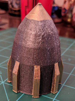

Then I got carried away painting it. I know that the paint will just come off after a few shots, but I had nothing to do today anyways :roll:
yeah I got carried away with the spray paint. The gold fins and tip kind of look like a drive band and a fuse which I thought was neat
Technically wise I know this isn't the ideal projectile. The fins are too small to have any real effect, and the squat shape doesn't make it the most stable projectile. But this was mostly just a test to see if it could be done, and tomorrow I will post shooting results.

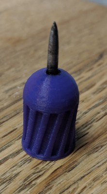

I'm taking a break from printing projectiles for my 2 inch bore cannon and I decided to experiment with some smaller 1/2" projectiles.
I designed this one to be somewhat like a foster slug, but I implanted a turned hardened steel spike into the tip to give it weight and allow it to stick into my targets.
I printed this one in purple because I kept losing the black ones which were hard to find in the grass.
What's nice about these are that they fit in both my sprinkler valve airgun and in my blowgun, so the compatibility is nice. They weigh a little over 2 grams, so they're still very light, but I find that you can get away with that better with smaller bores.
I was very surprised by the accuracy of this foster slug, it flies much straighter than any of my homemade duct tape darts and a lot faster too!

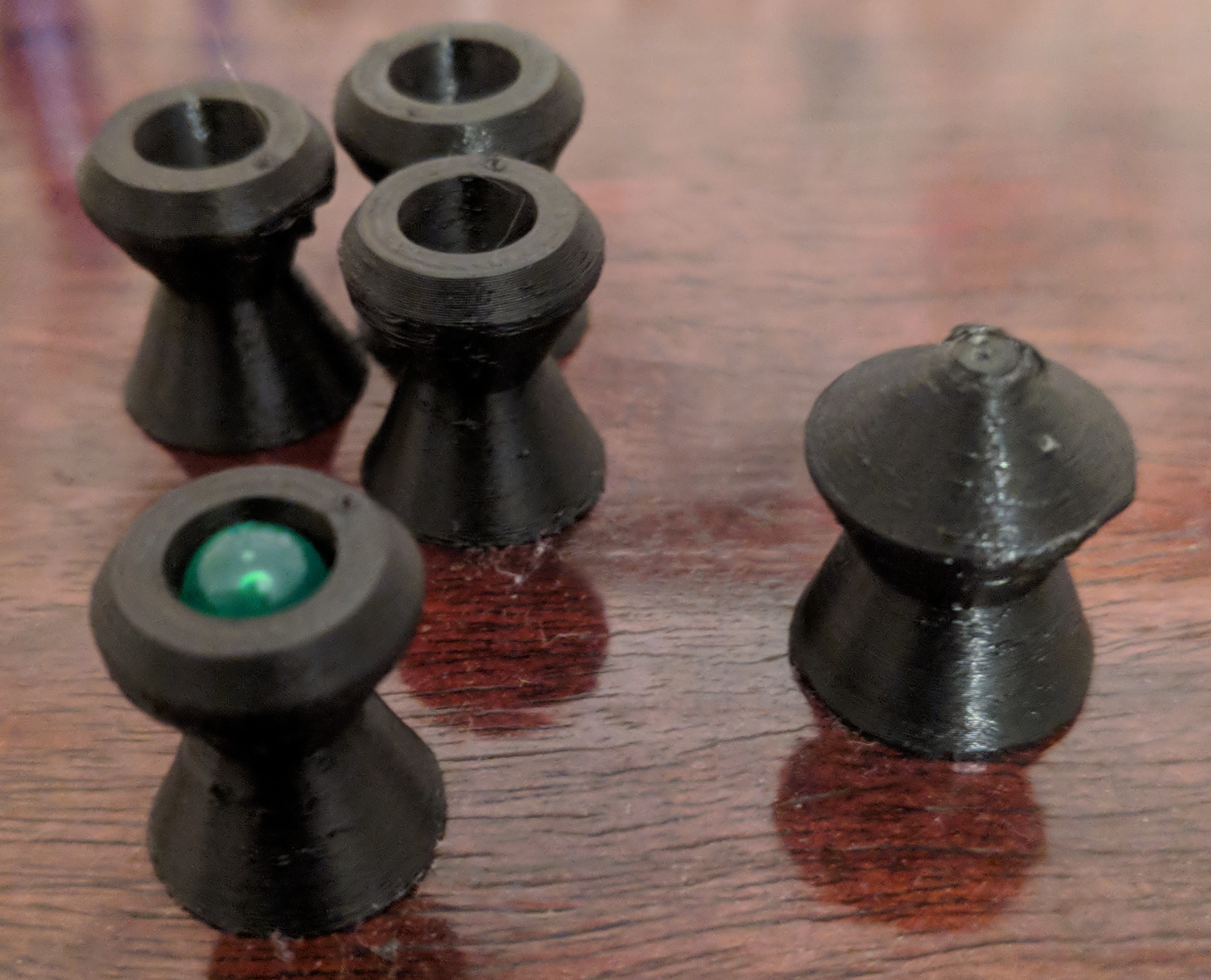

jakethebeast wrote:I have had somewhat of a success with some 3D printed diabolo style slugs, haven't tested those in larger calibers though
yeah, I messed around with diabolos for the 1/2" bore awhile ago and I had great results with them. I found that even though they often weighed only a couple grams, that they could fly very straight and far without tumbling. Maybe some 2" diabolo tests need to be conducted :scratch:
I found that the hollowpoint with a .12 gram airsoft BB glued inside the cavity flew the best.

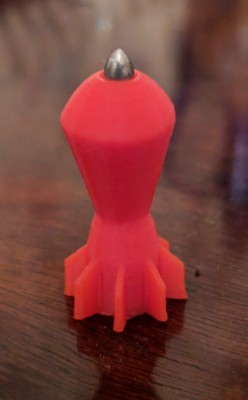

Just printed this little stinger :-P
I took the advice of the 45 degree chamfer on the leading edge of each fin (there are 8 total), and I'm excited to see how well they stabilize the little half inch projectile. I also made this one a lot longer than my previous projectiles (28.7mm tall with a 14.45mm diameter), primarily to increase stability but also because I wanted to increase the distance between the fins and the head of the projectile so that the wide head wouldn't deflect all the air going to the fins. I added a bit of a diabolo shape to help with the air deflection and to help weight balance. Finally, I epoxied a small steel spike inside the tip to add more weight and hopefully help the projectile penetrate into it's target a bit deeper.

That looks like it will work pretty well, make sure you film it :)

Fri Jun 15, 2018 3:52 am
Yea I think with the new design that puppy is gonna hammer what it hits. I don't think it's going to last long, the spike is going to split it like cutting fire wood. Only one way to find out! :bom: Would like to see this in a wind tunnel type test with smoke trailing over it... :mrgreen:
