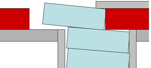

Oh and two more pictures:
Just need to weld on the mag well and the rest should be easy... But I have a strong feeling that this method of shell ejection will be very prone to jams.
Aside from that, I think you've covered the big ones. Function, innovation, quality. I would place a large emphasis on function. A gun that doesn't work is, well, not much of anything. Contestants should be required to provide videos of their guns being operated completely. And we don't just want a video of the gun firing off one shot, we want to see the full loading and firing cycle so we know it works- and well.
Quality of build is important, but obviously not everyone has access to machining equipment and that must be taken into consideration. Still, that's not to say one can't produce a quality gun with basic hand tools. We don't want to waste our time with duct taped barrels and epoxied soda bottle reservoirs. With quality comes durability, which should also be considered given the environment a Nerf gun would be used in.

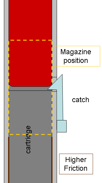

to prevent jams you'll just need to prevent cartridges from moving forward due to friction from the retaining bar, so you can make some sort of catch mechanism or adjust it so the areas in contact with the cartridge (besides the retaining bar) will have higher friction

also I guess I misinterpreted the design you were going with, in that case my concern would be something like this happening
- jam.PNG (7.44 KiB) Viewed 4224 times
