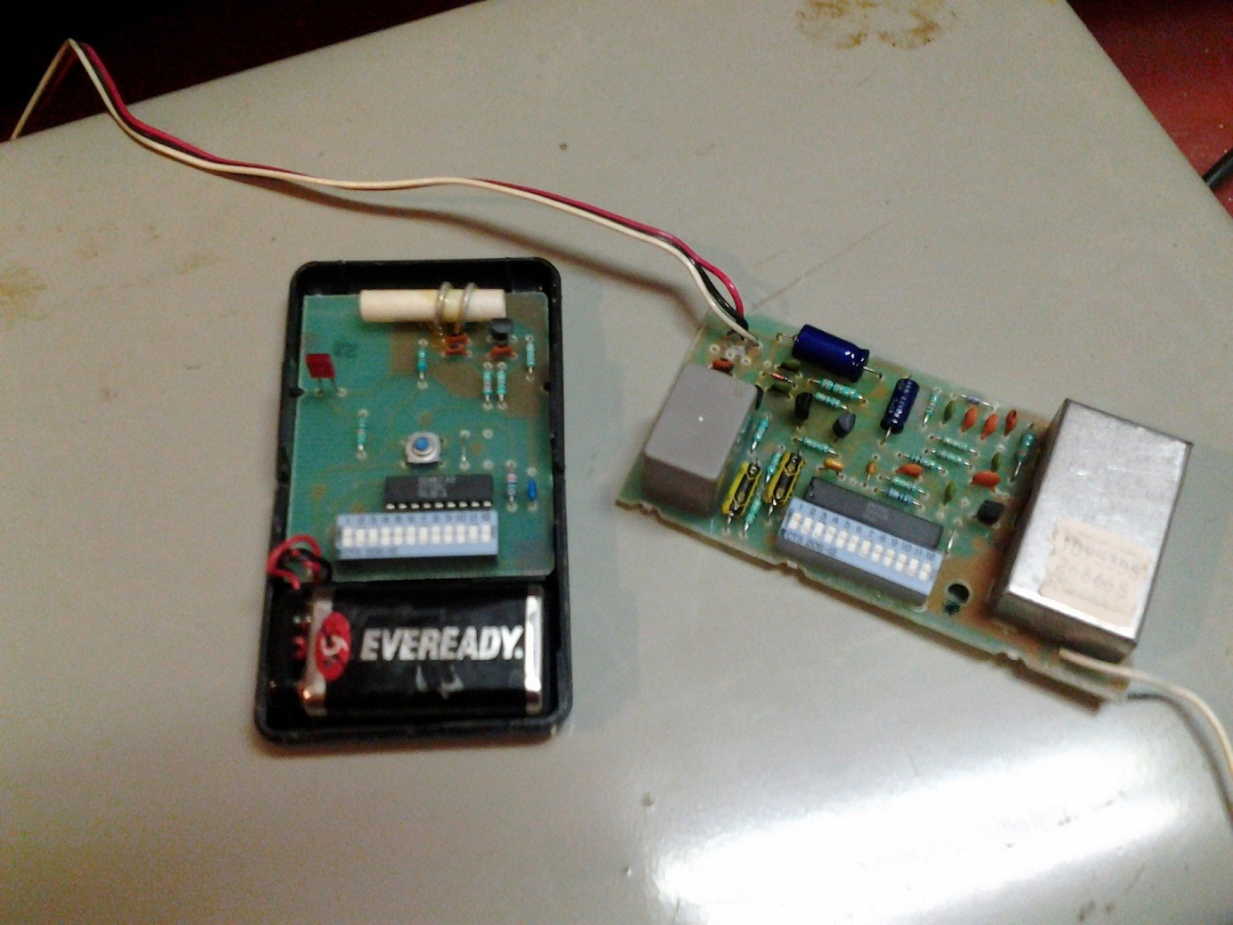

So recently I got hold of the circuits from an old Genie garage door opener. I wanted to use them as a remote detonator for airsoft satchel charges, but I know next to nothing about circuits. I'm guessing that two of the wires coming from the receiver get connected to a power source and the third gives off a pulse when the button on the transmitter is pressed. Does anyone have any idea how this thing might work?
transmitter on the left, receiver on the right

Take a better close up picture of the receiver both top and bottom of board with out the flash.
Also a close up of the receiver label on the metal case.
Do know the model/part numbers of each unit?

How's this? The label says 10953BS 26866S if you can't make it out. The transmitter model number is GT90-1 and the receiver model number is GR390-12.

Ok, the big box on the left looks like a relay, and I'm getting it will close between the white/grey and black wire.
Obviously the power is supplied in the red and black. I think the voltage will be 5 volts, check the voltage of the relay, should be either 5 or 12 volts.

Well the relay looks like an SPDT, I reckon just soldering onto the NO and common terminals should do the trick.

Most of those remotes with 3 wires are configured with Common, Power, and Output.
Some use AC at 18 or 24 Volts and some use 12 Volts DC depending on the model. When you press the remote, the relay gives a pulse connecting Common and Output to trigger the door. Look online for a book on the opener this was for.
