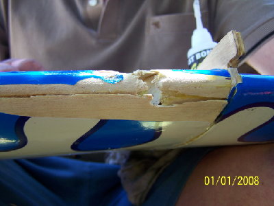

i fly rc airplanes. ive had worse, well, maybe not worse, but similar. go to the hobby shop and get balsa wood of the same thickness and cut it so it fits inside the fuselage where it broke. thats actually a fairly easy fix, you can have it good as new in just a few hours.
if that is an ARF or an RTF airplane, then you will probably want to get a roll of monokote or ultracote and patch it back up so it looks better. just put the time and effort into it and you will have a perfectly good airplane.
ps- what kind of plane is that?
edit-
You underestimate the power of the Duct Tape.
one of my planes does actually have a strip of duct tape on it, but that was a very minor repair.
edit edit- all of you guy that say it cant be fixed are totally wrong, like i said, i could have that plane in the air in less that a day. just get some balsa and some CA glue and it really will be good as new. if you go to any RC flying club, none of the planes are perfect, all of them have patches and countless areas where they have been repaired with balsa wood.

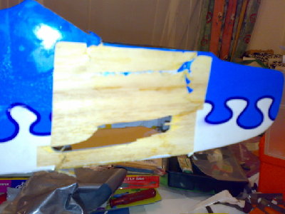

It did a barrel roll on take off. There are just two pieces those that you see. True never under estimate the power of duct tape... My elevator is held together with duct tape and withstands the pressures of Advanced aerobatics. Will post a pic of that soon.
Was also thinking of Putting balsa on the inside and out epoxy that and keep it together with bolts?

I have started. Hopefully finish tommorrow. will post pics when im done.

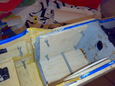

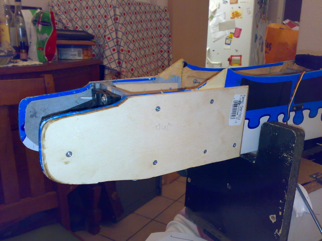

Here are some low quality pics so far. My proper camera is not working at the moment
Sun Jan 13, 2008 8:02 am
With the screws you added, time to break out the Center of Gravity Machine. I have to admit, I'm not a big fan on the open engine compartment. Great for engine cooling, sux for looks and areodynamics.
