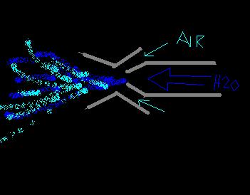

I think this is a great idea, but i think using 4500 psi is better for the amount of weight you want to move, it will get off the line quickly, and continue to accelerate a good little bit, this is a great idea. also, designing and implementing a air eductor on the outlet will greatly increase thrust, if your not familiar with an eductor, it uses a pressure source passing through a venturi point to increase speed, with an opening ... bleh ill make a picture...
crude, but it shows how the expanding water will pull air in( it will create a vacuum) and greatly increase thrust

Ok I'm gonna try to find an earlier post I made on the water rocket. But until then, The rocket you are going to need to use will have to be determined by your budget. Water rocket is by far the most powerful type of rocket as far as impulse goes (N/s) but it's also potentially the most expensive. The tank on one of those rockets are very dangerous if not properly made and tested. The same goes with the valves. They are designed and built for high temp. and pressure. Get past that and there will be plenty of thrust. There would be no real need for and eductor. 150km/h isn't very much however. I would just use solid fuel rockets or hybrid fuel. Hybrid provides throttling and inert fuels which could be beneficial. A Wiley Cyote solution but it's plain and simple. Just remember to use tires and brakes rated for those speeds.
