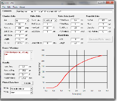

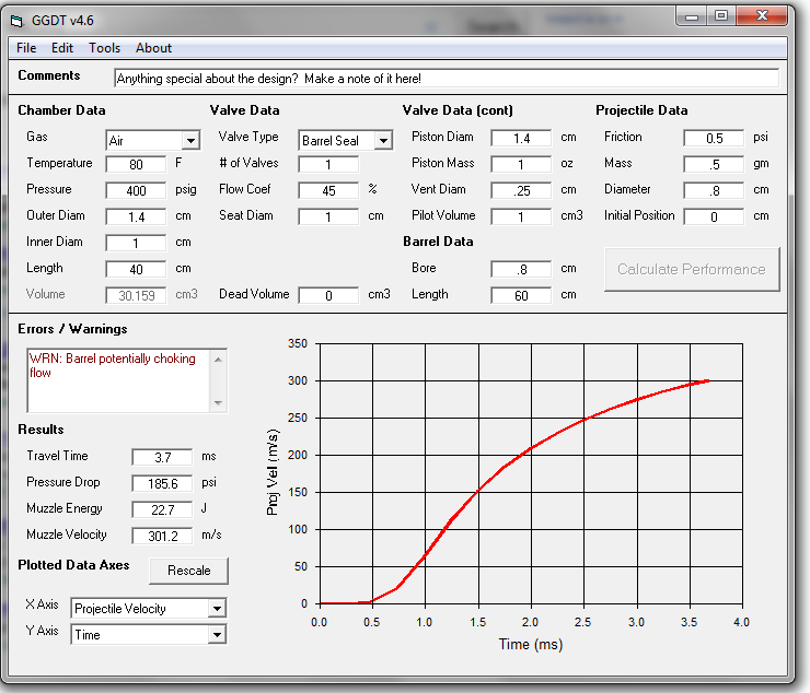

This doesnt seem right... seems rather optimistic. Did I put in a wrong spec?

it dose when compared to the last one, but it its correct then i think i might start making one strait away :lol: the only thing i see that is different is the pilot volume on this one is 1cm3 on the other one you had 5cm3, could that really affect it that much? wait i just checked again and you have got the projectile mass as .5 in the faster one and 25 in the slower one, i looked it up and i think they are about 2 grams each

Changing the pilot volume never does anything significant, it must be the weight. I looked up the pellets but they are different weights, and I didn't know what kind you were using. I'll try it with 2 grams and tell you the results.
191 meters per second/627 fps with 2 gram pellet.

thanks, its no 300ms but i think that is a reasonable speed and am sure it would be able to do some damage :lol: by the way i am planing on using these
