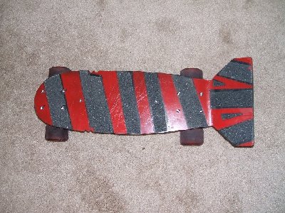

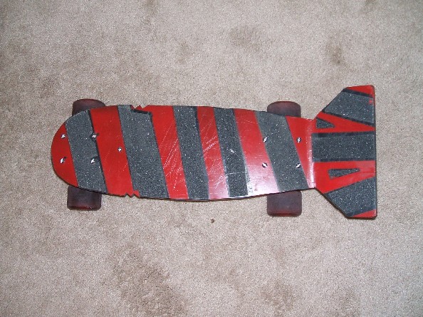

This is what I've been doing over the weekend! It was raining and ugly, so I stayed inside and made this:
A mini-board! It's almost 20" long, made from 3/8" solid ABS sheet. This shot only really shows the grip tape and red paint.

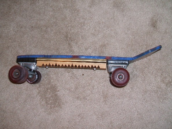

The tail's a bit high, the wheels aren't very red or clear in the picture, but who cares. <br />You can also see the 1/2&amp;quot; risers I put on.
You can also see the 1/2&quot; risers I put on.

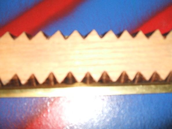

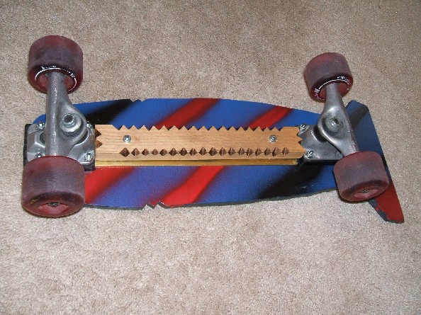

The bottom of the board, painted with a couple coats of blue, then random black and red stripes. The ABS was very flexible so I made a transbeam from brass, felt, and oak.
This thing looks very bad ass and you know it!

Nice job, looks good. Did you bend the ABS sheet or cut and glue it for the angled part?

Killjoy wrote:Did you bend the ABS sheet or cut and glue it for the angled part?
I heated it and bent it.
