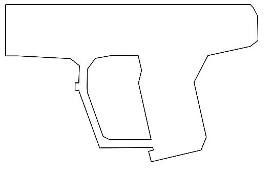

I've attached a picture of the outline of the Magnum. I figure that whatever I put in the Mag will work in the shotty as well. For reference, the mag is about 10" long and a little over 1" wide at slide. I know that there is room in the grip for a 12oz CO2 cylinder.

- frame.jpg (10.41 KiB) Viewed 8831 times

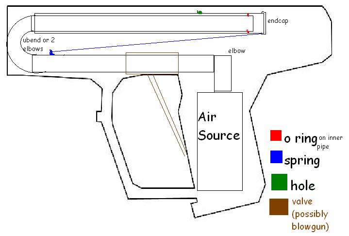

this design is something I drew up. when the valve is opened, the pressure pushes the outer pipe(and the part of the gun for blowback) back, until the equalization hole passes the o-ring, at which point the pressure releases and the spring pulls it back.
- i drew this into the outline provided
- blowback prop gun design.JPG (36.91 KiB) Viewed 8519 times
