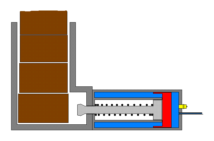

What the heck, piston valved launcher with a chisel on equipped with a return spring, pop-off valve for actuation, a log "magazine" and you have a full auto splitter :D

And JSR... what program do you use to draw your cross sections?

jackssmirkingrevenge wrote:What the heck, piston valved launcher with a chisel on equipped with a return spring, pop-off valve for actuation, a log "magazine" and you have a full auto splitter :D
LOL!!! That is awesome JSR. I'd say if you could make the mag adjustable for width and length, you could have a winner. For instance, after you chop all the rounds, you make the mag narrower and funnel in the halves.

Thu Jan 14, 2010 5:54 pm
I am afraid it's MS paint....
