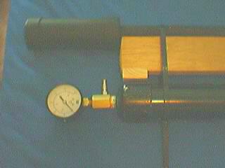

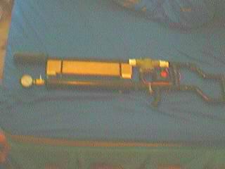

This is my first cannon I decided to make a riffle and change it around a lil i basically followed the instructions from http://members.aol.com/sph911/spud/sniper.html but changed it around a bit i releaised that the 9 volt batteries werent lasting long at all i went through 9 while testing and only got to fire 3 shots and their so i attatched a 12v rechargable elecrtic drill battery and worked great so i hooked it up to a switch

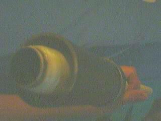

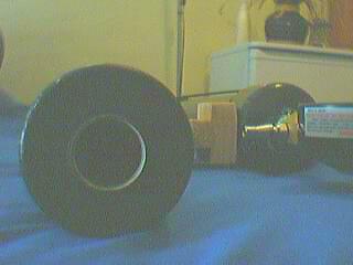

i also made a cilencer by drilling holes 6 inches long i made 4 rows all evenly seperataed and drilled wholes one under the other then i wraped pillow foam very tightly around the 6" drilled barrell 4-5 layers then i wraped it real tight with tape and filled the rest in with more pillow foam and sealed lid with a lil bit of the tip coming out no wholes on end tip

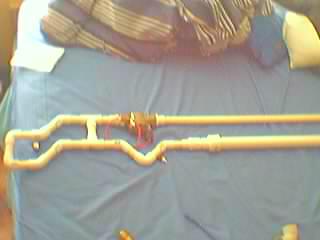

this was the original riffle i made i didnt glue it then decided to change it to wat i showed u
i have more pics of assembly and other designs i made b4 gluing it i will be more then happy to post you pics and info iam happy to share waht i know although there is still plenty for me to learn
those whising to comment on my gun please do as i need to know if i made any mistakes in order to learn from them do u think the 12v might damage the valve in any way please reply wth som info

- not glued..
- rifle2.JPG (8.23 KiB) Viewed 13984 times
- cilencer with lid and foam stuffed inside
- cilencerr.JPG (8.48 KiB) Viewed 13984 times
- note foam has not been stuffed yet just wraped
- silence.JPG (7.58 KiB) Viewed 13984 times

- riflle
- riffle1.JPG (7.69 KiB) Viewed 13984 times

its basicaly finished i painted the wooden frame i just have to sand everything but the barrel to paint it a flat black which looks much better and realistic than the 1 i previously usued i made the air chamber is 50mm and just abit longer than 16" and the barrel is 3/4" and 25 inches long i shot it at 20-35 psi and went 30-50 meters with a metro gumball
but by hand i cant seem to pump it further than 40 what do you think???????
could my airchamber be too small if i use a aircompressor and pump it further will it bust!!!!!!?
please help me on this becasuse iam not sure if it can take any more wen reaches 40psi seems to be full of pressure and pump handle wont go down
thanks people apreciate it

Well look at the psi rating on your pipe. It is pressure rated right? What ever pressure it says on the pipe I would stay a little under but you can get almost all the way up to it without it bursting. You probobly can't do it with the bike pump because bike pumps aren't very good for this they don't allow you to put a lot of pressure into something because on a bike you only need a little. Use an air compressor and pump it up, but I wouldn't get any closer than under 40 psi of the limit.
