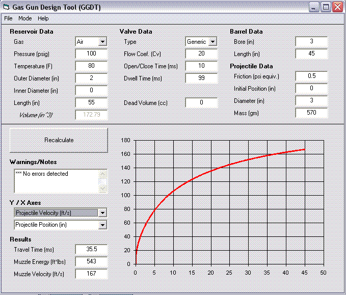

Anyhow, I tried using ggdt to figure out the best weight for the projectile, and according to GGDT and using the figures from the the archives it says that nothing will leave the barrel even though I was shooting 20 oz bottles of water about 70 to 80 yards.
the gun has a chamber 2 inch pvc and about 55 inches (including fittings) that I pressured up to 100psi released through a modded sprinkler to a barrel that is 3 inch pvc and 45 inches long

you didnt input something correctly, my ggdt says that you would get about 150 FPS with it, which seems reasonable.

That was the other thing I was going to use GGDT to play around with, and I have heard so many different things about the right ratio. So I figured I would just 0.8 like Burnt Latke (I know there's is for combustion)
What did I put in wrong?
"Inner diameter" should be zero as this is not a coaxial.
here's what I got:
here's what I got:
- voodooggdt.GIF (32.55 KiB) Viewed 3592 times
Yup, as Jack says, your inner diameter needs to be zero, and your outer diameter needs to be 2 inches.
It's a bit counter intuitive, but outer diameter is the internal diameter of the outer pipe in your chamber.
Inner diameter is the external diameter of any barrel that may or may not be running through the length of your chamber. As presumably, you don't have that, you need to set it to zero.

I don't know what valve you're using exactly so the valve data in my entry was generically guestimated so yours is probably correct, your main problem was the incorrect inner diameter.VooDooCC wrote:Thank you JSS. It was the id problem and the valve data being wrong.
