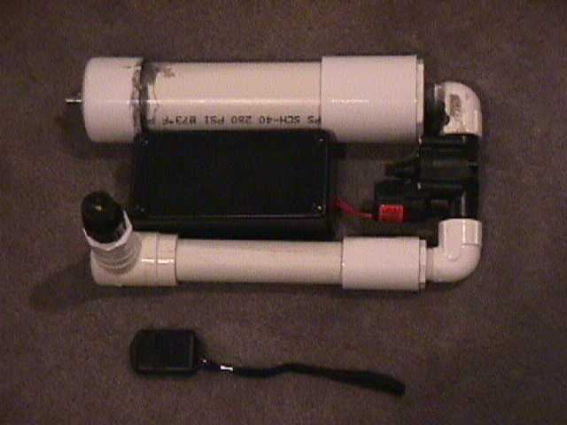

orbit 3/4 inline like shown below:
or link to the product page here:
http://www.orbitonline.com/products/Val ... 16/04/643/

Davidvaini wrote:orbit 3/4 inline like shown below:
Oh, that's exactly the one I had, except I had a 1".
It will work fine with 12V.
Now as for wiring it up, it should come with a diagram or something, so I wouldn't worry about it.
spudy buddy
Posts: 123
Joined: Thu Nov 29, 2007 9:27 pm
Sat Feb 16, 2008 3:01 pm
i have a 1 inch like that and it works with one 9 volt batery, so 12v should work fine.

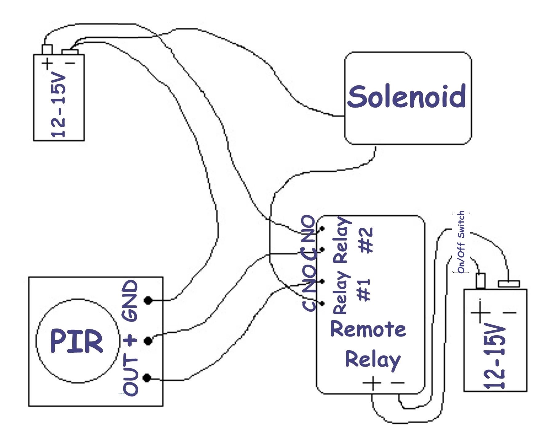

what is the PIR in the picture below?:
Mon Feb 18, 2008 1:27 am
Davidvaini wrote:what is the PIR
One of these, very popular with insugent IED techs in Iraq apparently.
