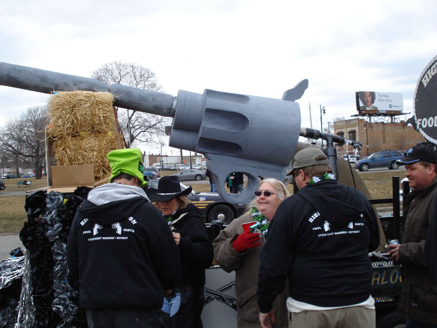

I was hired by the owner of a bar to make a gun that shoots confetti. The name of the bar is called the High Noon Saloon, so I made a 12' long western-style pistol, with the grip and cylinder (revolving part) out of carved styrofoam, and the barrel out of PVC. It turned out awesome!!

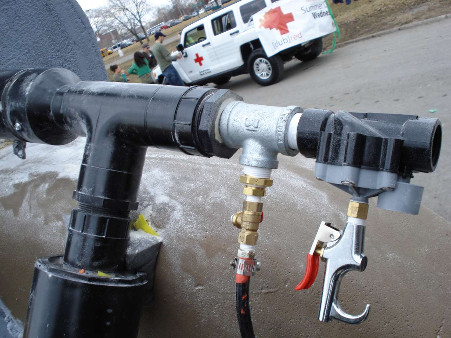

I decided to use a 1.5 inch porting piston valve instead of just a sprinkler valve or 2, mostly because I was given unlimited funds. I used a piston made of 2 1.25" end caps, with o-ring grooves carved with a dremel. The sealing face was a simple neoprene washer, and I used a cone shaped block of wood to center the piston on the sealing pipe. I can draw a diagram if that is confusing, but I think I saw someone use it here.
I wanted to keep the 2' long by 4" diameter chamber small so it wouldn't look weird and it would use less CO2. It's just a simple chamber.
I also made a breech loading hole with a modified coupler to cover it up. I carved with the Dremel (carefully) an L-shaped slot on the outside of the barrel for a screw to slide in, so it cocked like a bolt action rifle (sooo cool). We would grab 4 handfull's of confetti and scoop of flour (for a smoke effect), close the breech, and fire. It was so cool, I wish I got a picture of it firing. If anyone has ever shot confetti, you know what I mean. The barrel was the full 10 foot piece of 3 inch PVC with 4 inch PVC sleeving it, so it would look bigger (it ended up to still be too small, so we wrapped it in foam, looked awesome).

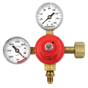

My CO2 setup consisted of a beer keg/soda dispenser CO2 regulator, and I used 20 ounce paintball CO2 tanks. I hooked up an ASA (paintball tank to 1/8" NPT adapter basically) to the input of the regulator, and screwed in a new tank when the old one was empty. I did this because I knew it would be too cold for the CO2, so we kept the unused tanks in the car to warm up. When we needed a full one, we just asked the driver to pass back a fresh tank (we had 5). I tried using a much simpler paintball regulator, but it didn't have enough flow to seal my not-so-perfect piston valve. This beer keg reg worked incredibly fast and after it was set up, it worked great. I suggest this to anyone who doesn't need a small or good looking CO2 set up. They are sold on Ebay for less than $50. I had 10 feet of tubing and a ball valve to control the filling.
Well, it sounds like a solid setup, not too fancy, right? Well, it was so cold (or the CO2 froze the PVC :? ) that the piston cracked, the sealing face was shot out about 6 inches into the barrel, and it rendered it useless. A simple thing that I never even thought of thinking of. Of course, it broke one block before the judges stand. I think I'll use nitrogen next year :twisted: .

The piston valve, filling tube and ball valve, and modded sprinkler valve for piloting.
The entire pistol. It was awesome when it shot!
This is similar to the regulator I used.

Wow...beastly.
Does it have a special "boom" when shot?

Yeah, it actually started moving out of the styrofoam body that we drilled it through because of the recoil. I took it as a compliment because that means it's powerful :lol:

Some pretty good craftsmanship there. Nice gun overall. For something like this, I probably would have just went with a 2" sprinkler valve and avoided having to deal with a piston...top notch performance not really being necessary.

It wouldn't take too much to make a quick dump valve. With the o-rings, mine doesn't leak and is highly reliable. If you hollow out the revolver, the valve/tank assy could be entirely concealed inside the styrofoam with the hammer connected to the trigger rod. Details on the quick dump valve is on my thread.
Sorry for the hi-jacking of the thread, but it looks like the valve would be a good fit for your revolver and remove the plumbing off the back.
http://www.spudfiles.com/forums/viewtop ... tml#238380
The bottom video shows the 2 inch version of the valve in operation launching t shirts.
Well, it sounds like a solid setup, not too fancy, right? Well, it was so cold (or the CO2 froze the PVC ) that the piston cracked, the sealing face was shot out about 6 inches into the barrel, and it rendered it useless. A simple thing that I never even thought of thinking of. Of course, it broke one block before the judges stand. I think I'll use nitrogen next year .
I have had extremely high failure rates of PVC pipe caps as pistons failing. CO2 isn't the issue. The stress and impact is. I've moved to HDPE for my pistons. It is the same material used in milk jugs, cutting boards and natural gas pipe. With high impact resistance and tear resistance, it holds up well. I'm on my 3rd quick dump valve cannon with zero failures. Nitrogen won't fix the problem.
