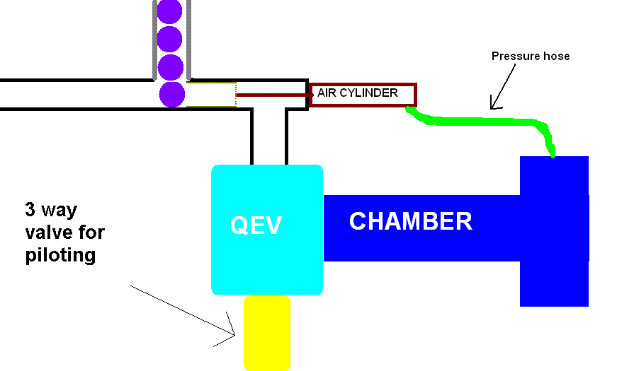

ok, I'm having a little trouble with scale there. What size is all of that?
I would just forgo the stock, to make it more portable and all.
Other than that, it looks great!
- POLAND_SPUD
- Posts: 5402
you might consider building it in a different way... becasue there is a lot of deadspace and it seems it might be difficult to use the pilot valve
something like this (it's not exactly what you should do but it should give you a rough idea how it can be arranged )

well the slide valve actually works best in the position that it was in, given a trigger mounted to it or something. It is almost impossible to use when mounted vertically, though your method of mounting the cylinder is great.
- POLAND_SPUD
- Posts: 5402
I think that it is possible to make a trigger with a slide valve mounted vertically.. sure it won't be as easy as making a trigger with horizontally placed valve...
I still think it's a better idea to use a 3way valve and I am sure that there are dozens of places where he can buy it.. but of course I was considering using a slide check valve myself
well one way or another i think that the design has to rearranged.. his design has way too large dead space, short barrel (while having long overall lenght) and the magazine tthat has to be placed far away from the shooter (near the muzzle).

No, not if the spudgun were run at adequate pressure.judgment_arms wrote:wouldn't the breach open as the chamber dumped?
If the force from the chamber pressure exceeds whatever return force there is, then the cylinder won't start cycling.
I imagine that the chamber pressure won't fall low enough - with an adequate C:B ratio - for the cylinder to start movement until well after the dart is gone.
When I (hopefully) use the design on 3vo, the loader design may require an additional system to be added to delay the cylinder further - 3vo will run across a very wide pressure range (likely 50-500 psi), and may as such need it to ensure correct operation across an order of magnitude, but I doubt it's needed here.

if you've got all that extra volume that must be dumped, well there goes efficiency and ROF will be limited also...
there's a lot of timing to get this thing singing, and in the end it still has an efficiency issue...
since you've already got a ram, why not just throw in a 3-way and run it autococker style, with the trigger controlling the firing valve and the cycling?
by the way, is the new LRC done yet?
