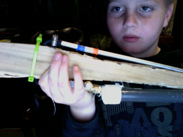

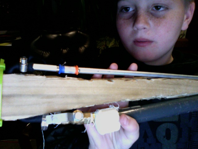

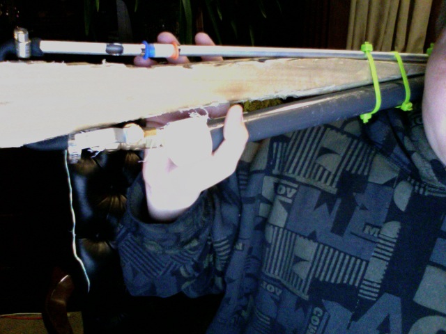

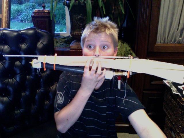

ok here is my new bb gun
chamber: 3/4 inch sch 80 pvc
barrel:2 feet of 1/4 brake line also 3 feet of 5/16 brake line

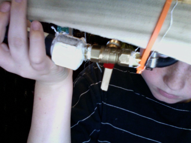

valve:1/4 ball valve
fill valve: screw in schrader
This is a small, but powerful little plinkler. It can shoot straight through a steel soup can from about 25 feethttp://www.youtube.com/watch?v=wKGoqNsJEiU&fea ... annel_page

I see you gave up on your coax....
Looks pretty good. Take out the Zip ties and it would be cleaner in my opinion, but otherwise pretty cool.

cool little bb gun u should add a qev and tighter fiting barrel and copper tank that would be awsome :twisted: :twisted:

Good improvement. I would suggest a smaller chamber because with that slow valve, the bb would be gone way before that chamber is close to being empty. What pressure do you use?

nice gun 2 things that can make it better though:
1. get a sprinkler or QEV valve and then use the ball valve eto pilot it, it'll only cost about $15 to do but will make a huge difference.
2. this is a more long term improvement, replace the pvc chamber with copper or brass because it looks like it has all brass fittings except for the chamber, doing this will allow it to handle much higher pressures, and has the added bonus of you being able too fill it using a co2 tire inflator, which can be bought from any bike store.
I understand a 1/4 inch qev, but a 3/4 sprinkler is way overkill.

Pretty cool gun you got there. Definitely get yourself a QEV! You could just use one of those sprinkler valves. Finally, get rid of those zip ties so you can work on some aesthetic improvements. Keep building man! Cheers 8)
