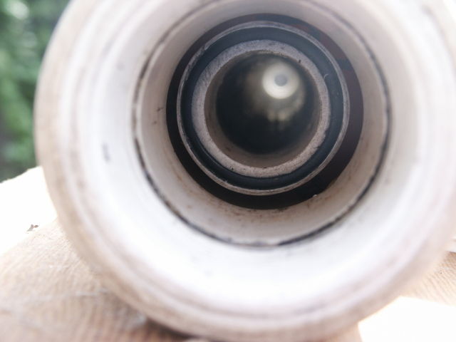

For me in the mouse musket, I simply took some poly tubing and cut pieces an inch or so long and zip tied them to the barrel about 6 inches from the breech. They compressed slightly going into the chamber on the Mouse Musket and worked fine. Maybe you need a hint of the size of the gap between the barrel OD and the chamber ID. The Mouse Musket is a coaxial with a 1 inch PVC barrel inside a 2 inch PVC barrel.
In terms of flow, since the air expands as the pressure drops the highest velocity is near the piston. The other end of the chamber doesn't see much flow. I position the support somewhat away from the piston to reduce friction loss and turbulence in the high flow area. The support does not have to be right at the breech to be effective.
Piston travel should be limited to between 1/4 and 1/2 the diameter. Minimum for flow is 1/4 diameter. I allow longer travel in mine for a higher coef. Part of the travel is into the bumper where it decelerates instead of hammering itself to bits.
I'm not quite sure of the gap and t piece you refer to, so I can't answer that question.
Mouse Musket valve seat.  Barrel is suspended by 3 pieces of poly tubing zip tied to the barrel about 6 inches from the breech.
