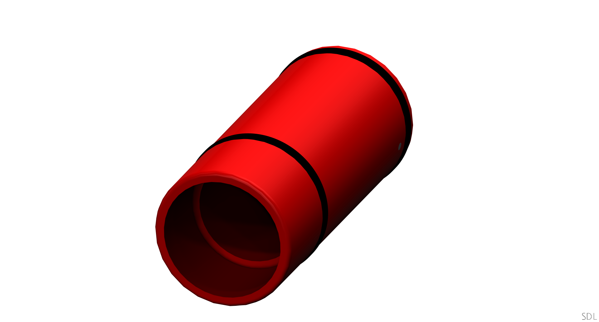

Sam@UoN
Posts: 11
Joined: Thu Oct 15, 2009 7:07 am

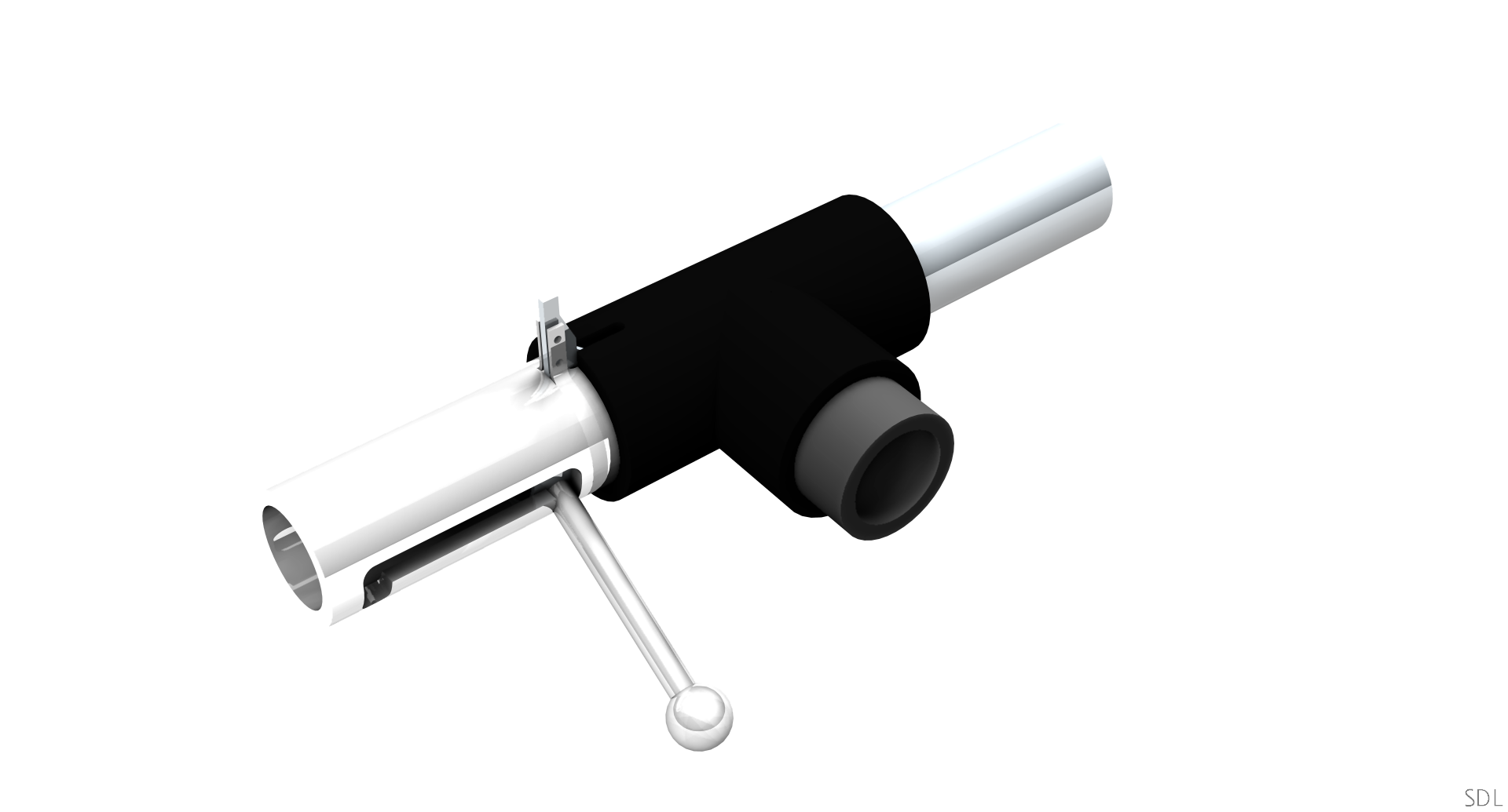

Sat Oct 17, 2009 5:44 am
I should have the pro/e models done either tonight or tommorow - i've found a 2" high pressure PVC TEE that should do nicely and some 2" - 1.5" reducing bushes so that would leave a cavity where the 1.5" piston seals...
Anyway I will post when they are ready - right now I'm being forced into bloody food shopping with the mrs!
Thanks for all your help thus far fellas

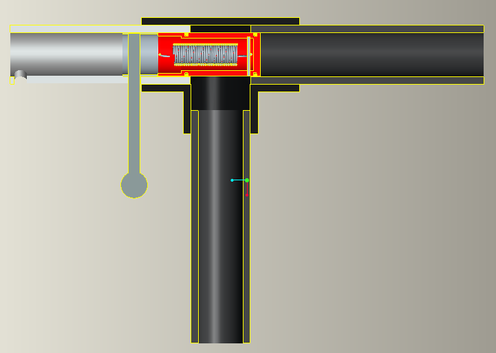

Sam@UoN
Posts: 11
Sun Oct 18, 2009 5:12 am
Will do a better job when i have more time tonight but here is a quick screen grab...

here is a link to a part of a video that ive made
let me know if anyone can see anywhere for refinement
I should also say that whilst they are not modelled the is an extension spring between the bolt and pison and an end cap on the left with a damper screwed into it...

Tue Oct 20, 2009 4:29 am
Very nice. I like the animation. My only concern is the peak forces where you decelerate the piston. Do you have plans to absorb the kinetic energy of the piston in a safe manor?
Sam@UoN
Posts: 11
Tue Oct 20, 2009 9:58 am
Yeah a 60J spring damper assy - will work a treat
