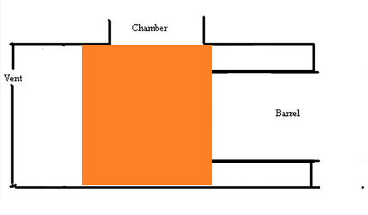

tghhs
Posts: 176
Joined: Wed Dec 31, 2008 11:01 pm
Wed Feb 10, 2010 3:38 am
Well, if your only option is what you've posted, then yes option 2 is your best beat.
Though if i were making your valve id have the barrel come right up to where the chamber goes off and use a solid piston. First this would mean that there would be no choke on the flow except for opening time and that a solid piston will be much easer to make and will have a less chance of jamming and breakage.
something like this. The important part is where the barrel ends. Preferably use a light material for the piston.
Also talke note of the pic at the botton of this thread, You will have to sand out the fitting to make a good piston that will work.
http://www.spudfiles.com/forums/first-p ... 20258.html
Better piston design.png (11.74 KiB) Viewed 2182 times
Netherlands
Posts: 3497
Wed Feb 10, 2010 5:15 pm
You could round off the edges on the front of the piston to guide the flow to the barrel port.
( talking about the solid one)
You could use option two, but it will tumble.You need more length to the back piece to make it center properly.
