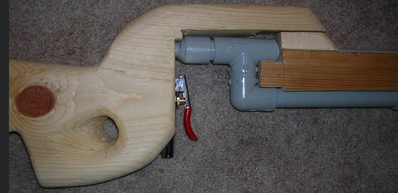

6mm pellet launcher
I started out to make a 6mm launcher last summer and it fell to the wayside shortly after it's beginning. The parts lived in my closet for nearly a year before my interest and funding permitted me to complete the project. This is the result.
As you can see it's a simple barrel sealing T-valve triggered by a blow gun. The only modifications to the blow gun were to remove the OSHA approved nozzle, grind off the finger loop, add some thread sealant to the valve body and to epoxy the blowgun to the brass T connecting it permenantly to the launcher. I had to do this in order to get the threads to seal in the orientation I needed them in.
The barrel is made from an 18"(it's actually 19.5") section of tubing for sink/toilet repairs with roughly a .24" ID(OD 3/8") . The piston is cast epoxy with red valve repair rubber(sold in 6x6" squares) superglued to it.
The resevoir is ~8.5x1/2" sch 40pvc. I cut down the T and elbows to reduce the form factor and then placed 6 #4x1/4" screws and then the joint is smothered in epoxy. I need to add some more due to a pinhole leak that has developed.
Everything is glued together, so if anything catastrophic happens I'll have to rebuild the entire launcher and may be unable to scavenge any of the parts. But due to the low price of small diameter pipe I'm not too concerned. The most expensive part is the blowgun, which would probably be removable, although a bit time consuming to do it gently.
The foregrip is friction fit to the air chamber and barrel with a piece of 12ga fencing wire serving both as a barrel pin and a front sight. The stock is attached to the foregrip by 4 machine screws with nuts epoxied into both sides but these are the only bits of hardware holding the launcher to the stock. While not amazing robust, I'm not planning rifle butting anyone with it.
The wood work could have conceivably be done with no power tools if you had a handpowered drill/auger on hand as it was largely shaped by a chisel and hobby sized plane. It is varnished to protect against water and such.
In the future I may attach some sort of proper optic, but for now I the longest range I've been able to shoot at was 12ft. It still had the oomph to punch through a soda can bottom at that range too.

Very nicely put together, kudos. How small calibres however, I would advise against low pressure high volume, get yourself a shock pump and some metal fittings and you'll be amazed by the difference in performance.
I am using a shock pump(rated to at least 250 the packaging is a little vague). The main reasons I haven't taken it to higher psi is 1) there are a number of leaks I need to fix 2) the pump is extremely low volume so it takes hundreds of pumps to get high pressures.
I used limited metal because I have no plans(or money) to take it into the HPA realm and 1/2"pvc can still handle 600psi, even factoring in my modifications it should be able to handle 3-400. Which with airsoft pellets(+0.2g) or #4 buck(1.34g) will put out respectable fps at 250psi (914 & 470 ) and ft-lbs( 5.7 & 10.1 ). These pressures are also above what most commercial shock pumps are rated for.
As of now I'm pretty happy where it's preformance is, it's just for plinking and perhaps persuading racoons and possums to go mess up someone else's garbage.

I use the same barrel, there cheap and easy to get but are flexible
That is all.
That's the point of using shock pumps though, in general a smaller chamber at higher pressure will give you more power, even for the same amount of air (eg 10cm<sup>3</sup> chamber at 50 psi vs 5cm<sup>3</sup> chamber at 100 psi) - have a look at this GGDT exercise to get an idea - and proportionally your chamber is far too big for a single shot launcher. Thisis the sort of performance you can get from small chambers and high pressureDeceiver wrote:the pump is extremely low volume so it takes hundreds of pumps to get high pressures.
Not trying to knock your design, it's certainly very well made (I'd applaud epoxy construction anywhere
Mine is rated for 400, love it to bitsThese pressures are also above what most commercial shock pumps are rated for.
You and your super shock pump! 8) Oh I know the air chamber is far too large(and inefficient) for the barrel size, but I don't have anything to get into the more efficient high pressures. I'm envious of the power of your burst disc launcher.
Although maybe in the near future I might lop off a couple inches of air chamber. A quick number crunch says .608ci @ 200psig should put out 708 fps and 3.4 ft-lbs.
Although I'm a bit attached to the possibility of 10ft-lbs coming from the massive 8.5"(2.6ci) air chamber on it now.
The barrel flex is counteracted by the foregrip and held down by the front sight. It seems to be pretty consistant and at the short distances I've been able to test it at have been 11ft and I've had to aim like 9" low to hit my target. Perhaps at farther ranges the hold-under will be more reasonable.
