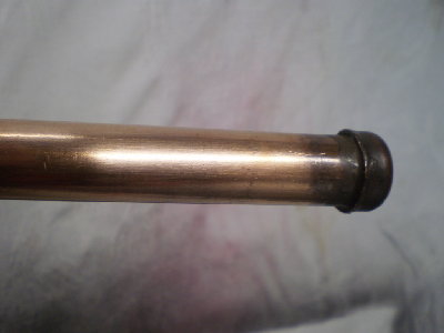

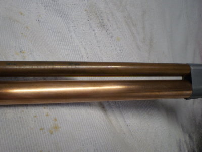

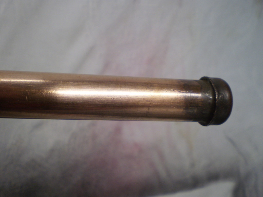

Hi, im building a 400+psi QEV bolt action copper rifle, with a oak stock.
4x32 scope. ammunition Holder, and bi-pod.
The gun it's self is about 60% completed and i just finished polishing the 3/4 copper chamber but the soldered weld's remain and i believe that
"If your not happy with it it's not finished."
So what would be the best way to remover them?
3/4 chamber with 1/2 barrel running alone length.
polishes 3/4 chamber with ugly weld's.
I don't fail. I succeed at finding what doesn't work.
-Mat.
Tue Jul 13, 2010 5:04 am
The light coating of solder and coper oxide from heating can be easly removed by using 0000 steel wool. After the surface is clean, then proceed to polish with your favorite metal polish. A buffing wheel and jewler's rouge works well and so does Brasso.

I only used steel wool and ran it from top to bottom a few time and it seems like it weld marks really don't wanna go.
