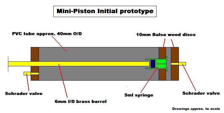

Here's some thoughts on piston travel and pilot volme.
Do you have any tips for me building a piston valve as my second cannon?
If you know your materials well, it should be a doddle.
This was my third pneumatic which I built back when I was 17, I knew nothing of plumbing then but knew plenty about model aircraft, and the choice of materials reflects it, but the idea is that basically you take the principle and adapt to the tools, materials and know how you have to hand.
