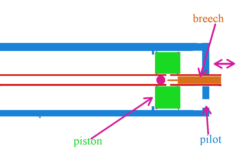

I was reading this thread: http://www.spudfiles.com/forums/viewtopic.php?t=8278&
The question was aksed: how do you breech load a coaxial?
The question was answered, but I have a different answer. And I didn't want to dig up an old thread. Seems TWTTTS get very upset about that.
And since a picture is worth a thousand words, here is my answer:

Or throw in one of your favourite valves et voila, co-ax semi-autoPOLAND_SPUD wrote:...or you can load ammo from behind though you'd need a special doughnut shaped piston

Uhmm that would actually make a pretty cool gun. Since the whole gun is just a long tube (ohh btw you could add a silencer with the same OD as the chamber) you could easily make a nice stock for it (or just use one from a cheapo airgun)
POLAND_SPUD wrote:Uhmm that would actually make a pretty cool gun.

For a useful number of shots the chamber would have to be at pretty high pressure assuming you're only using the co-ax chamber as an air tank and not feeding through the pilot and dumping the chamber for every shot.

Well actually I've been thinking of an external tank...For a useful number of shots
though who said you can't add an on board pump?

Exactly the reason I am considering a coaxial for my next build.POLAND_SPUD wrote: Uhmm that would actually make a pretty cool gun. Since the whole gun is just a long tube

I'm so glad this topic was brought up. I'm currently working on a coaxial piston pistol and I've been scouring by brain and the internet for ideas on how to breech load it. JSR is totally right, every idea I come up with a seem to run into problems making the mechanism airtight (but it shouldn't be a problem now). I am now considering using a pinball style mechanism to load the projectiles from an external magazine into the barrel. For larger scale cannons with relatively smaller barrels I'm also drawing stuff up on loading ammunition from the piston. PolandSpud's picture is fantastically helpful.

I agree. I like Poland-Spud's idea the best.SP00K wrote:I'm so glad this topic was brought up. I'm currently working on a coaxial piston pistol and I've been scouring by brain and the internet for ideas on how to breech load it. JSR is totally right, every idea I come up with a seem to run into problems making the mechanism airtight (but it shouldn't be a problem now). I am now considering using a pinball style mechanism to load the projectiles from an external magazine into the barrel. For larger scale cannons with relatively smaller barrels I'm also drawing stuff up on loading ammunition from the piston. PolandSpud's picture is fantastically helpful.
