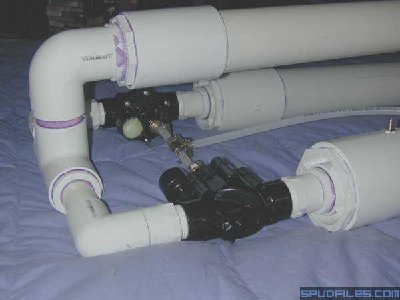

As a way of getting my feet wet, I built an simple over-under design using a 3/4-inch sprinkler valve, but its performance was very disappointing. It was obvious that the solenoid and low flowing sprinkler valve was the bottleneck in the design, so I built the second generation using two Rain Bird CPF-100 one-inch valves in parallel and used pneumatic triggering. Both feed into a 1-1/2-inch T which leads to the 2-1/2-inch barrel, which just happens to be the right diameter to fit a tennis ball. The U-shaped pressure chamber is made of 3-inch tubing with two 90-degree elbows. All tubing is schedule 40 PVC and is rated to over 200lb. The barrel length is about 47 inches, while the pressure chamber is about 32 inches long. By my calculations, the barrel has a volume of about 220 in 3 and the chamber 530 in 3 for a ratio of about 2.4:1.
The pressure chamber is drilled and tapped 1/4 NPT where the tubing overlaps the joiner sleeve (double thickness) on either end of the U in order to install the Schrader fill valve and the pressure gauge. The solenoids were removed from the sprinkler valves and the opening filled with plastic bonding epoxy. The valves were disassembled, the flow rate adjustments were removed, the shaft holes drilled out and tapped 3/8 NPT and a brass barbed fitting screwed into place. Pressure-rated poly tubing joins the two valves with a barbed T, and from there it goes to a dust blower valve which serves as the trigger. Screwed into the nozzle of the dust blower is a ball valve which acts as a safety.
PVC tubing is not recommended for use with pressurized air. Although this design uses air pressures well below the tubing's rating, any flaw in the tubing or fracture caused by impact to the pressure chamber while pressurized could result in explosive failure and plastic shards traveling at high velocity. If you build a pneumatic launcher of this or any other design, you do so at your own risk. To mitigate this risk, I recommend the following:

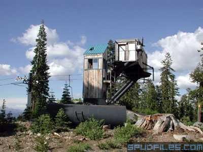

Our field day site for 2002 was the top of a lift for the Iron Mountain ski resort located in the El Dorado National Forest. This was a marvelous location with a clear area surrounded by tall trees, ideal for antenna hoisting. For a while we toyed with the idea of hooking a transmitter to the lift cable.

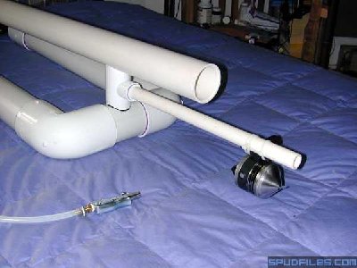

The Penn reel was loaded with 300 yards of 50lb woven Spectra fishing line. I really liked this line for antenna raising, it was light, didn't tangle (much), and it didn't stretch when yanked so you could really feel what you were up against when pulling the line back in. Although my forest green line was practically invisible, I understand that it is also available in fluorescent colors, which I would recommend. Also remember to have a pair of leather gloves handy when pulling the line -- the thin, strong line can cut unprotected flesh like a knife.
The method I developed for attaching the tennis ball is a little tricky, but seemed to work in general. The first step is to choose a leader line to go between the Spectra and the ball. This line should be of lower breaking strength than your main line in case your ball gets stuck in a tree and you have to pull and break it loose. In my case, I chose 15lb woven Dacron line, but I think that was a mistake because it kept breaking on launch. Next time I will try something with a little more give in it, maybe nylon if I can find some the right weight. Once the leader is chosen, you will need two steel washers, about #10, a knife, a punch, and a crochet hook. The procedure is as follows:
Cut the leader long enough to almost reach the muzzle when the ball is at the bottom of the barrel, plus enough for a loop in each end: one an inch or so diameter, the other big enough to pass a tennis ball through. Tie these loops with a figure eight loop knot.
Cut a slit in the tennis ball case wide enough for the washer to fit through. Opposite the slit, punch a hole through the case.
Push the crochet hook through the slit and through the hole. Hook the small loop in the leader and pull it back through the ball and out the slit.
Thread the small loop through the first washer. Pass the loop through the center of the second washer, then loop it around the washer so that it makes a lark's head knot.
Push both washers through the slit while pulling from the opposite side with the leader. When finished, the knotted washer should be resting on the threaded washer, which distributes the force over a wider area and keeps it from pulling through the hole in the rubber case.
Tie a small loop in the end of your main line on the reel and use another lark's head knot to attach the leader by passing the large leader loop through the small main line loop, then passing the tennis ball through the large loop and pulling it tight. This allows you to prepare several tennis balls with leaders ahead of time and attach them as needed. It also allows you to detach the ball and attach a messenger line once you've gotten the ball through the tree.

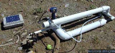

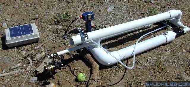

We found through trial and error that the best mounting position for the reel was such that it extended beyond any other part of launcher, so that the line could swing as wide as it needed to as it spooled off of the reel without contacting any obstruction. We initially tried a shortened fishing pole with line guides, but this was a complete failure. The line from the reel to the loaded ball should not be past anything that the line might snag on. In the setup above, a small notch was cut in the tubing the reel was mounted on to guide the line in to the muzzle. Note also the small hand-held 12v compressor and battery pack to power it (the box with the solar panel on top).
The initial live firings of the launcher with line attached almost always resulted in breakage of the leader. As we developed better techniques, we were able to increase the percentage of successful launches, but we were never able to go above about 40psi without breaking a line. In practice, this was more than enough for our purposes, since the highest tree we topped only required 25psi to clear, and most needed less than 20.
In practice, the launcher performed better than any other antenna raising system we've tried to date. It wasn't so much that the launcher could do things the other systems couldn't do, but that both its high consistency and its ability to be fine tuned combined to allow us to eliminate the errors of the previous launch without introducing any new errors, almost guaranteeing a second launch success. The tunability of muzzle velocity by varying the pressure also gave us a great deal of flexibility in picking the launch angle in order to land the ball in a clear area on the other side of the tree.
