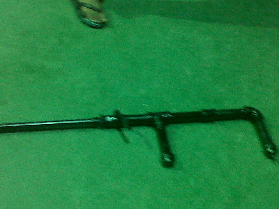

HEY MATE
I JUST WANTED TO KNOW WHICH AIRCOMPRESSOR U USE BECAUSE MY EMERGENCY AIR COMPRESSOR CAN PUMP US 200 - 300 PSI MAX....MY GUN CAN HOLD A GOOD 600 PSI + BUT I CANT FIND A GOOD AIR COMPRESSOR..SO JUST ASKED...THNX MATE!!
CHEERS
CHEERS

HACKERZLORD007 wrote:HEY MATE
CHEERS
USE THE SEARCH MATE, now if you typed that nicely maybe i could help you

I tried searching google,yahoo and loads of other sites but all i get is heavy duty industrial air compressor!! The one i have is:Crna Legija wrote:HACKERZLORD007 wrote:HEY MATE
CHEERS
http://www.alibaba.com/product-free/216 ... essor.html
It can pump usually to 300 max but it kills the battery so usually i have to limit my shots to 200 psi which sucks....my gun is fully galvenized metal capable of doing 500+ psi but its a pity having a gun which is so capable but lacking the compressor!!!!
Help would be appreciated!
CHEERS!
