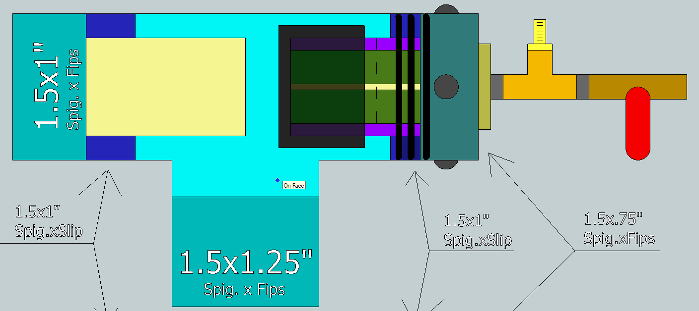

I've always wanted to build a compact piston valve, i.e. one without the female adapter behind the tee. Maybe you could do one in 4"? Then make a semi auto beer can loader

						Could you describe this a little more?Gun Freak wrote:I've always wanted to build a compact piston valve, i.e. one without the female adapter behind the tee. Maybe you could do one in 4"? Then make a semi auto beer can loader
And also, I don't think I'm up to machining a housing out of a massive piece of PVC. I also only have a wood lathe so I probably wouldn't be able to do it anyway.

If you have a drill press, you can make a piston housing.
He's talking about a piston housing that is fully contained in the Tee itself without any fittings to lengthen it.
so many muchness
						Ok I understand. I'm not too interested in machining a piston housing though unless it is necessary for a more complicated design. The problem is that I would have to order the PVC stock online which will be expensive.Gaderelguitarist wrote:If you have a drill press, you can make a piston housing.

You don't have to machine the piston housing...
Shown with rubber cap piston. May be hard to understand. Ask for clearification

I like it!
Looks eerily familiar though...
http://www.spudfiles.com/forums/my-firs ... 12796.html
