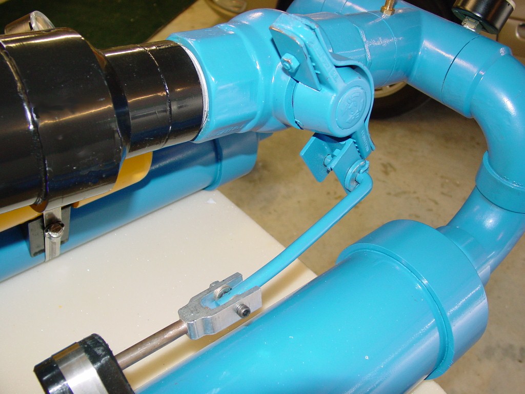

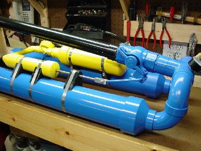

After some digging through the bowels of the interwebs, found it!
Website is dead but dug up some pictures though mark's site:

aEx155 wrote: A 1/4" QEV should flow enough to move a small piston enough to open a ball valve. No need to reset any springs.
Why not delete the QEV as it seems a bit redundant? The ball valve on the gun below is actuated by pneumatic cylinder and controlled by a 3-way solenoid valve. You could use a push button valve for a trigger rather than a solenoid.
