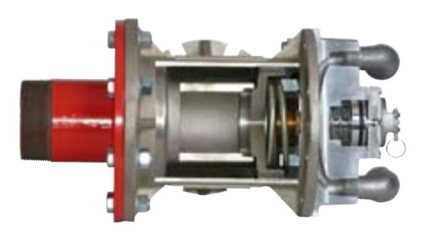

- Posts: 5189
								 Fri Mar 25, 2011 10:53 am
			Be sure to look at the internals of commercial piston valves to look for prior art.  In particular, I would recommend looking at the Martin Engineering products in the Hurricane and Tornado lines.
http://www.martin-eng.com/products/big- ... air-cannon
Check the operator and maintenance manuals in PDF form on the site.  Is your design anything new?
- Martin Tornado valve cut away.  2 inch, 4 inch and 6 inch sizes
- Martin Tornado.jpg (24.3 KiB) Viewed 4750 times

								 Fri Mar 25, 2011 5:02 pm
			Ah yes, I reviewed Martin's stuff before well before my project. The only similarity is that Martin's valves and mine are both piston valves.
The specific internals of my valve and how it pilots are different and "new" from other valves as far as I can tell from my research the past few nights. Only time will tell if this is true though.
