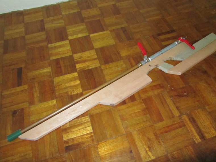

Here's what I've been working on during my free time. A ball-valve airgun was simple enough to put together, without taking up too much time and effort. The stock isn't a solid piece, they're made from separate planks, I'm going to epoxy the handle, butt and foregrip together. I also need to shorten the ball-valves' handles and set up the trigger. Maybe paint it?
The barrel is .45 copper & the air-chamber is 1/2'' x 8'' steel pipe. Currently using 40gr+ naildarts @ 100psi. I hope I can find a good shock pump that doesn't leak and take it up to 150psi - 180psi. I hope. :P
1 question, if a ballvalve is rated at 150psi is it okay to take it up to 180psi to 200psi? 30-50psi pass the rated point? Is it safe? Will this damage the valve?

update, sorry it took so long been busy. Anyway Finish putting together my ball-valve airgun :D
Uploaded with ImageShack.us
Shot into a wooden shelve, also tested on different hardwood boards @ 100psi I can get these darts 1/2'' deep. On softer variety/parts of wood It drives them almost 1''+ deep.
Accuracy -sigh- not so good. 4'' groupings standing offhand @ 10meters(30feet). With a rest I thought it would be much better but only improved slightly with 3'' groupings. I'm using 2'' naildarts (2.7g)

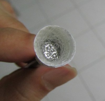

Here's a fiberglass paper cone I made to withstand high pressures. It's made by layering 3 layers of fiberglass tape atop a piece of paper.

Another update: Made it a little lighter by cutting the front, did a little sanding, and I spray painted it black.
The guns actually ready, just needs a shock pump.
