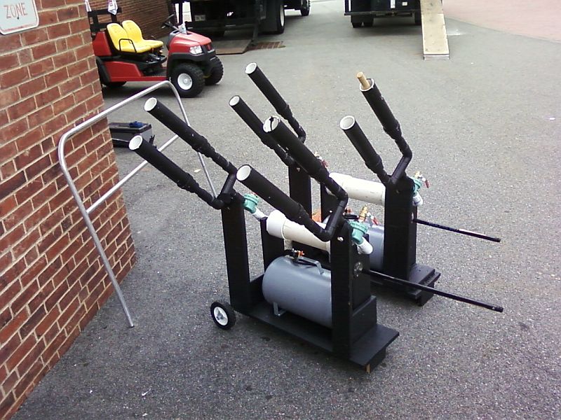

I built these 2 air cannons as props for the high school marching band that 2 of my kids play in. The concept of the show this year is medieval knights, castles, etc. So the idea of flaming arrows shot from the "castle" came about. The idea is to shoot 2 arrows from each side of the field at the start of the show, and 2 arrows from each side at the end of the show. The launchers and one person to fire them hides behind large panels on the field that serve as the castles.

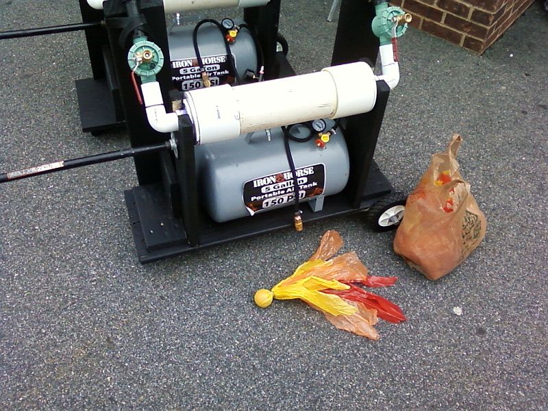

The supply tank is charged to about 100 PSI, and the regulator fills the upper chamber to about 50-60 PSI. This pressure can shoot two 2" dog-toy tennis balls with the plastic bag "fire" about halfway across the football field and go about 40 feet in the air. We can get about 4 or 5 shots before the supply tank needs recharging.
The valves are modified Orbit 1" sprinkler valves with ball valves to make them fast enough for this purpose.
I learned a ton of info from this site, from how to modify the orbit
valves to GGDT usage.
2" dog-toy tennis ball wrapped with red/orange/yellow plastic bag material to simulate a flaming arrow.
Supply tank, regulator and upper chamber of launcher.
1" orbit sprinkler valve modified into QEV.

Thanks for all the comments, and I happen to be an engineer, so maybe that's why I don't ask many questions?
By the way, the launchers were used last night at Metlife (Giants) stadium in NJ. Fired from the sideline, the "flaming arrows" landed on the far line of hashmarks for about 30 yards distance. Looked like 2 penalty flags were thrown :-)
Waiting to unload and set up on the field.
I'm the guy behind the prop panel wearing the burgundy jacket
