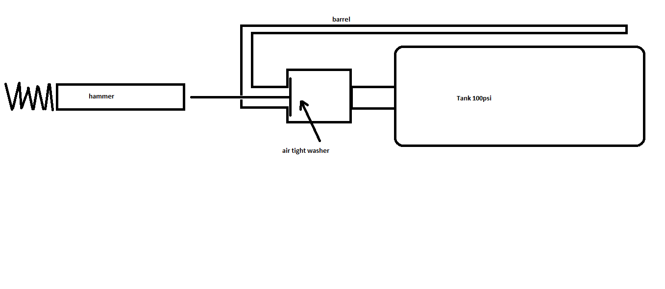

To cammyd would this be the kind of set up?
Hammer valve rifle.png (12.12 KiB) Viewed 3336 times
cammyd32
Great Britain
Posts: 326
Sun Apr 20, 2014 4:53 am
Indeed it would, Wyz did a very good tutorial on converting a blowgun to a hammer valve a while back, have a look, saves on you having to design and try and fabricate your own, which can be quite a chore for someone who I'm guessing doesn't have access to their own lathe. and given they only cost around 3-7 quid, it doesn't really break the bank to experiment and play around with them.
Just, when you're making it, ensure you maximize flow on all your components for ball bearing firing.
personally I think using a chamber at pressures of around 250 - 300 psi would be a good idea (or more if you're really power hungry) with those kinds of pressures and a powerful hammer I've put 3mm ball bearings straight through soup cans, and that was with a really inefficient set-up, I'm sure you could do better with a good flow and larger bore
Hope that helps, :)
