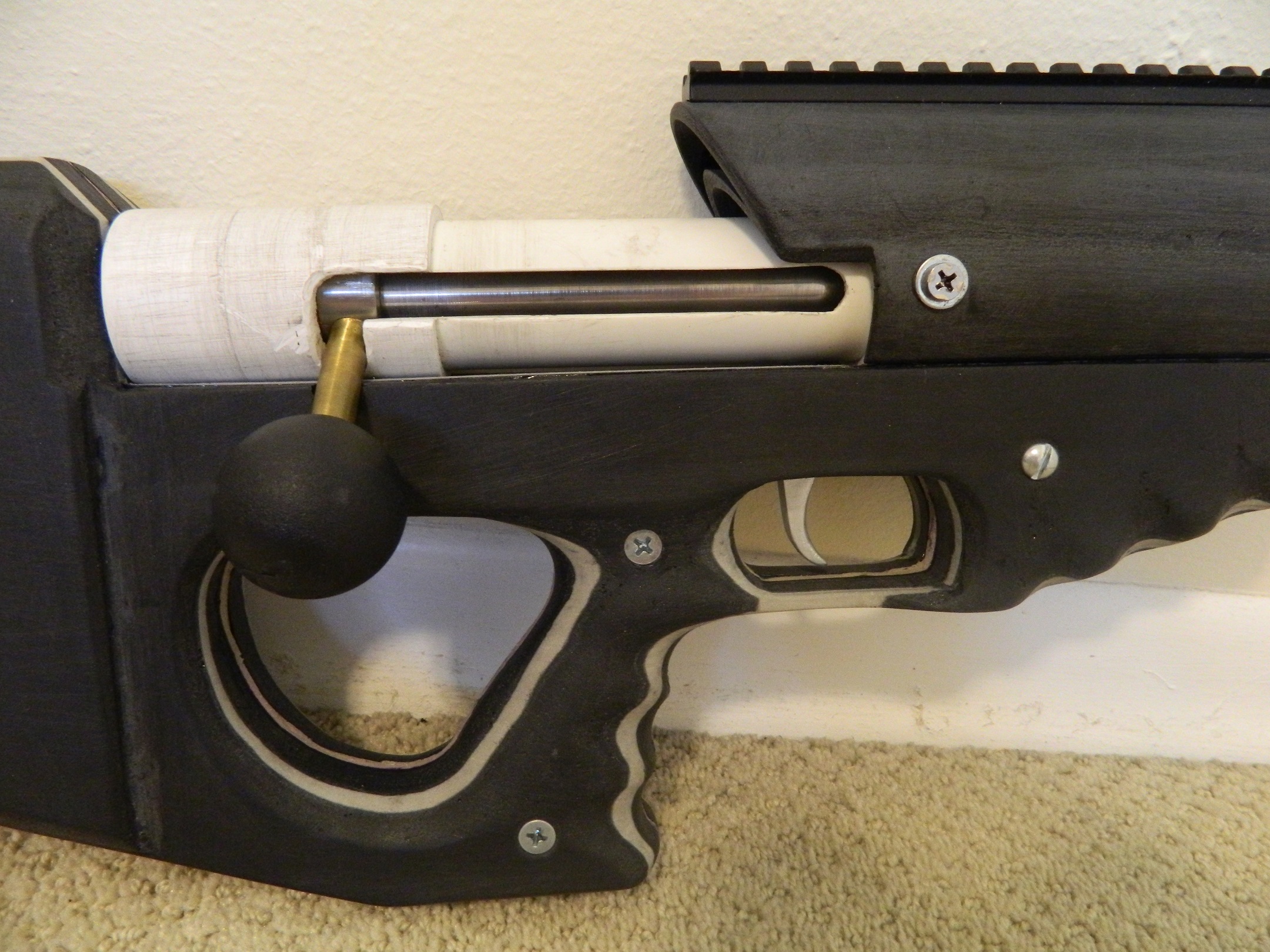

Thank you! I think it would be better if you watched my disassembly/reassembly video to get a better idea of how everything works:
I got a chance to test out my idea of adding a smoothbore extension to the rifled barrel. It wasn't as accurate as just the 10.5" rifled barrel by itself. It did seem to do a bit more damage to the stool though. The damage is shown at the end of my shooting video:
I decided to go back to having just a rifled barrel because it isn't that much slower and it's more accurate. Plus it's a lot more compact and light.
And here are some pictures of my final setup and a picture of the rifling:

Looks like the barrel moves in and out to expose the breech for loading. Is there any play in the barrel when locked in position?
Any tips for solvent welding the big pieces of ABS? Did you roll on the glue?
I'm still amazed how good it looks.
On the video you mentioned just tapping and releasing the trigger instead of slow pull... I thought a QDV would respond just fine to slow pull.
auxiliary
Posts: 145
Joined: Sun Jan 20, 2008 12:01 pm
Mon Mar 13, 2017 12:02 pm
There isn't any play in the barrel when locked because of the two points of contact. It is a similar sealing system to my most recent combustion cannon "The Jackal" where the wedge of the bolt slide forces the seal against both surfaces.
For the laminating process I just used the standard brush-in-can inside the ABS glue and worked quickly. I would do it layer by layer and press it down as I built it up and then stood on a big board to compact it for a while. I didn't want to make a press.
The tap and release issue was because my piston was a little too tight (it had to hold 800psi back) and the return spring was quite stiff too so the valve needed an extra hand to open all the way.
