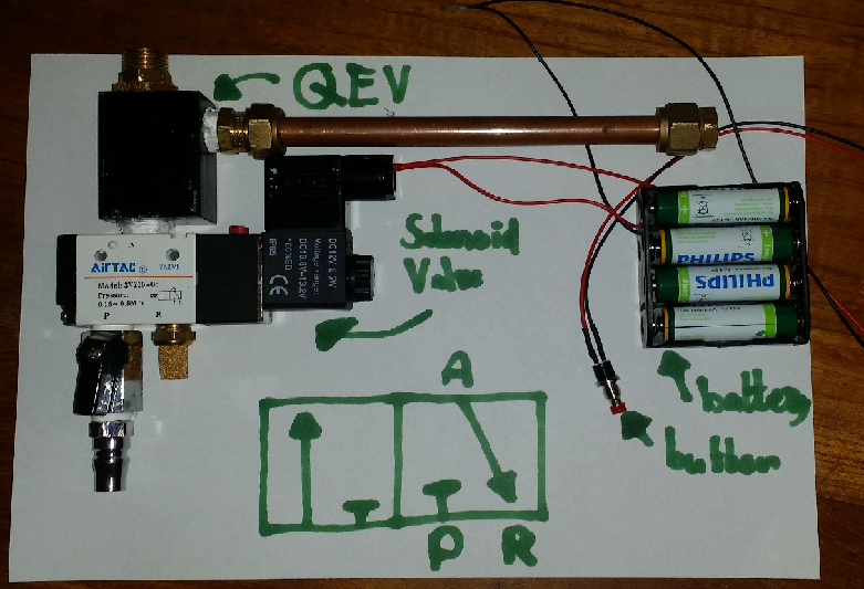

After using a spring return 3-way-2-position valve for a while to pilot my QEV, I decided to order a solenoid valve. It came in yesterday and I immediately tried to install it. It was my first time messing around with wires and all..... but I'm pretty sure I installed it correctly. I run a simple QEV with chamber and as mentioned previously a solenoid valve setup, this is shown below:
Now here is the problem:
When I attach the air supply to port R, I hear a light sissing noise which indicates there is some kind of leakage. Then when I press the button to power the valve, I hear the coil doing its job but it does not switch ports. I suspect that is has something to do with pressure difference.
I was pretty sure that I had to attach the air supply to port R. To make sure I wasn't doing it wrong I attached the air supply to port P to test it. At port P, I still hear a light sissing noise. But now when the button is pressed you hear the chamber of the QEV filling up (which makes sense when you look at the schematics). Then when i release the button, air is released from port R and the QEV pops. Of course this is the desired effect but that would mean that i constantly have to power the solenoid. and it still doesn't solve the problem for the leakage at the valve.
I have no idea what i am doing wrong, but i think it has something to do with the lack of pressure at the ''unused'' port.

Hi, port P is for filling. But sounds like you have NC valve (normally closed) and that means your chamber will only fill when solenoid is powered. For use like that you should have NO (normally open) valve that fills your chamber when solenoid is not powered and closes the P port when powered. Leaking sound is probably from leaking valve :D

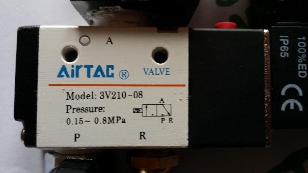

Here is a picture from closer by.

BramR wrote:Here is a picture from closer by.
The attachment solenoid.jpg is no longer available
Yeap, thats a pilot operated valve. So to use it you need a constant pressure at port P. Thats the same reason the valve says 0.15-0.8MPa pressure and not 0-0.8MPA :D
Because it's NC/normally closed valve it's dangerous to use it with qev since if you lose power from low battery or bad connection etc. it will shoot :!:

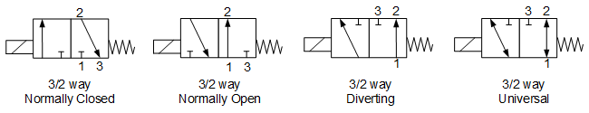

Heres a valve diagram to show the difference of NO and NC valve in their diagrams: http://solenoidvalveshop.co.uk/img/arti ... nction.gif

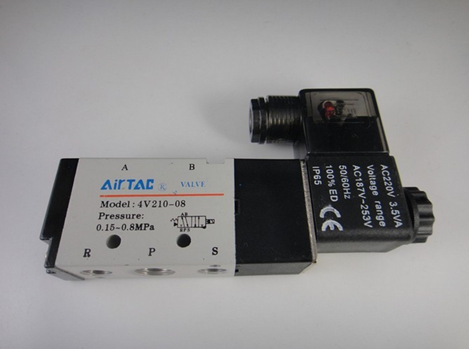

When i buy this 5/2 solenoid valve, i basically cant do it wrong as long as i seal one of the ports so the air supply wont leak out?
http://www.ebay.com/itm/1x-4V210-08-5Po ... ilOZYWy1rg
Its an 5/2 solenoid because for some reason it is cheaper than a 3/2 only 8,55 dollars:D

That should work OK ! :D It's very cheap valve so not sure what the quality of those are. I have used some Herion 4/2 valves that are over 10 years old and they work perfectly still, but they are qood quality ones rated for many millions of cycles.
