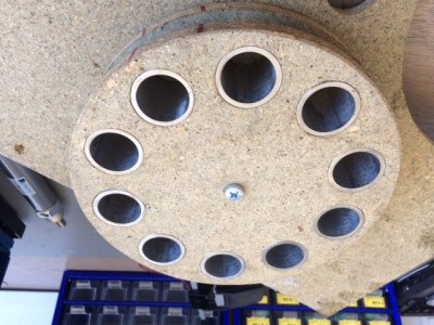

I want to build a fully pneumatic air cannon and one of my biggest problems is the revolver mechanism...

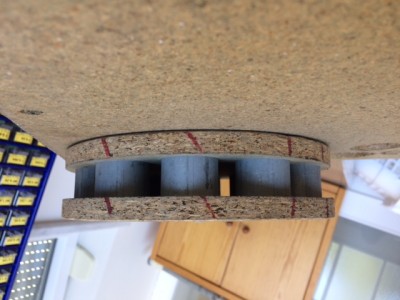

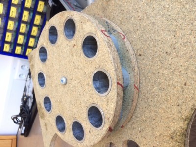

So maybe you can give me some tips how to move / rotate and lock the revolver drum in the right position only with one or more pneumatic cylinders
At the attached pics you cam see the actual construction...
I hope someone has a good idea!
Much greetings from germany
Thomas
Rotation mechanism Revolver pneumatic
