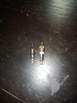

I also received the schrader cores I ordered: 9914B short cores from an aviation supply. They're rated to 4000psi and fit in any old schrader valve body. I hope this lasts long too, because I got sick of replacing valves whose seals were destroyed from the pressure.
