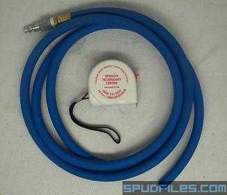

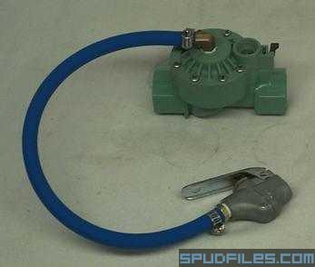

Step 6: Cutting your hose<br /><br />Your next step is to cut your hose to the desired length. I have chosen to use 1/4&amp;quot; id by 1/2&amp;quot; of air hose. This is available at Mcmaster.com<br /><br />After you cut your hose to the desired length you will want to insert one end into the barbed adaptor on your valve cover and the other end into a 1/4&amp;quot; male adaptor. Secure both ends of hose with hose clamps. Next, cover the threads of your male adaptor in Teflon tape and thread it into a blowgun rated for at least 100 PSI. You are now all set to start using your souped up sprinkler valve. Enjoy, and as always, Keep it safe…
Your next step is to cut your hose to the desired length. I have chosen to use 1/4&quot; id by 1/2&quot; of air hose. This is available at Mcmaster.com
After you cut your hose to the desired length you will want to insert one end into the barbed adaptor on your valve cover and the other end into a 1/4&quot; male adaptor. Secure both ends of hose with hose clamps. Next, cover the threads of your male adaptor in Teflon tape and thread it into a blowgun rated for at least 100 PSI. You are now all set to start using your souped up sprinkler valve. Enjoy, and as always, Keep it safe…
Additional notes:<br />If your now obsolete solenoid is getting in the way you may simply scrap it, however you must fill both small holes in the solenoid port with epoxy.
Additional notes:
Once your adaptor has been threaded into your cover you may replace all parts inside your valve and screw the cover back down.

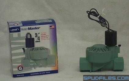

Step 1: Buying the correct valve<br /><br />The first thing that must be done in order to soup up a sprinkler valve is to buy the valve. There is one major thing to consider when buying a valve, does it or doesn't it have a guide rod? A guide rod is a small metal bar inside the valve that guides the diaphragm. I have found two different valves that don't have guide rods and are very simple to work with and soup up. The first valve is a Rainbird 1” inline automatic sprinkler valve. The second valve, the one pictured below and through out this how to, is a Watermaster 3/4&amp;quot; inline automatic sprinkler valve.
The first thing that must be done in order to soup up a sprinkler valve is to buy the valve. There is one major thing to consider when buying a valve, does it or doesn't it have a guide rod? A guide rod is a small metal bar inside the valve that guides the diaphragm. I have found two different valves that don't have guide rods and are very simple to work with and soup up. The first valve is a Rainbird 1” inline automatic sprinkler valve. The second valve, the one pictured below and through out this how to, is a Watermaster 3/4&quot; inline automatic sprinkler valve.

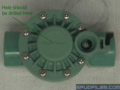

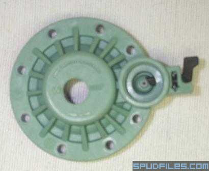

Step 3: Drilling hole in cover<br /><br />Once you have removed your cover you need to drill a hole in the center of it. You will thread a 1/4&amp;quot; barbed hose adaptor into this hole. You can either use a 1/4&amp;quot; NPT pipe tap or you can simply drill a 1/2&amp;quot; hole and thread it with your fitting. Make sure that the hole will not be in the way of the spring. If your valve has a guide rod, drill to the side of the cover but make sure that it isn't in the way of anything. If you plan to use a 1/4&amp;quot; pipe tap, instead of the 1/2&amp;quot; hole, drill whatever size your tap recommends.
Once you have removed your cover you need to drill a hole in the center of it. You will thread a 1/4&quot; barbed hose adaptor into this hole. You can either use a 1/4&quot; NPT pipe tap or you can simply drill a 1/2&quot; hole and thread it with your fitting. Make sure that the hole will not be in the way of the spring. If your valve has a guide rod, drill to the side of the cover but make sure that it isn't in the way of anything. If you plan to use a 1/4&quot; pipe tap, instead of the 1/2&quot; hole, drill whatever size your tap recommends.
This is what the top of your valve should look like after drilling the hole.

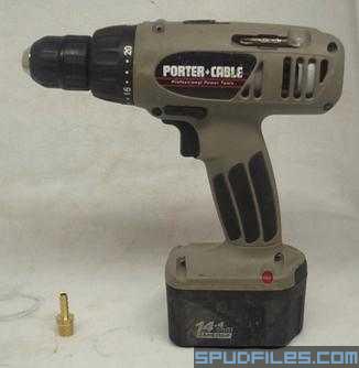

Step 4: Tapping the hole<br /><br />Now that your hole has been drilled you are ready to tap it for your fitting. If you are using a pipe tap simply tap the hole and move on to step 5. However if you don't have a pipe tap and are going to be threading the hole with your fitting you will need a drill and a 1/4&amp;quot; male barbed hose adaptor.
Now that your hole has been drilled you are ready to tap it for your fitting. If you are using a pipe tap simply tap the hole and move on to step 5. However if you don't have a pipe tap and are going to be threading the hole with your fitting you will need a drill and a 1/4&quot; male barbed hose adaptor.

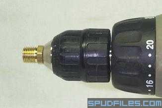

You now want to insert the hose adaptor into your drill chuck like this:<br /><br />Now slowly and as straight at possible spin your adaptor into the hole. Once you have gone almost all the way, about 1/16” of threads still showing, stop. Remove the adaptor from the drill chuck and then remove the adaptor with a crescent wrench.

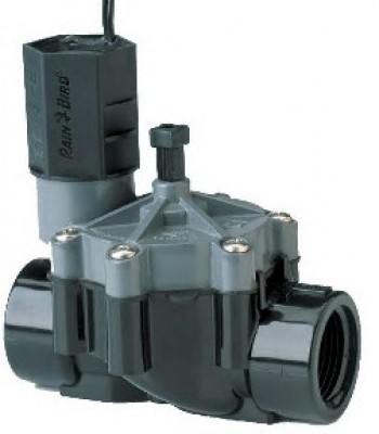

This vavle should work shouldnt it? Second can you drill your hole for the air fitting somewhere besides the center because if i do the spring on the inside wont have any where to sit.
Rain Bird CP-100
Rain Bird CP-100

Hi pimpmann
From what ive found this model of valve doesnt release fast enough.What i ended up using is the Rain bird Apas-075
hope this helps
