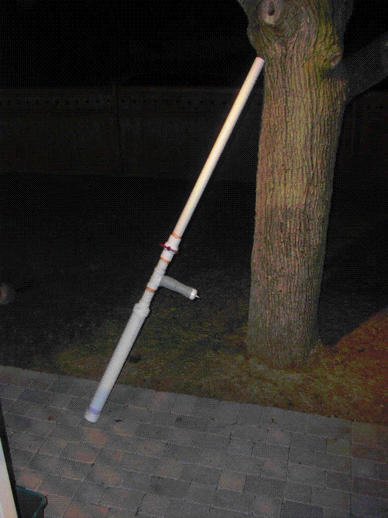

This spud launcher shoots fast and far but runs on low pressures such as 25 psi. I shot a rubber ball ou of sight into the sky, no exaggeration.

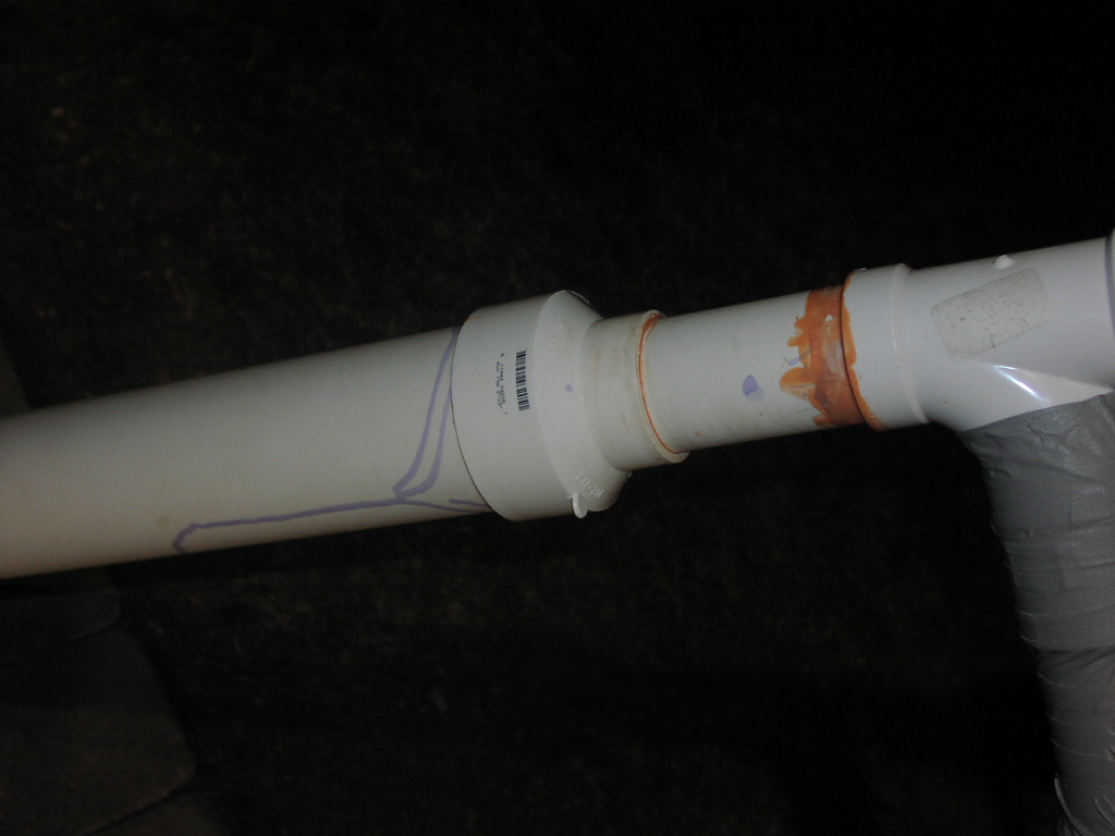

3 inch:2 inch converter to make the gun shoot faster and farther.

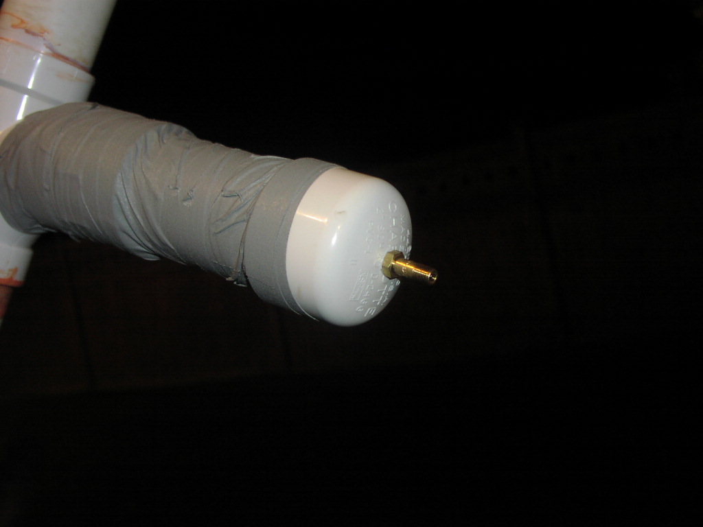

Shraeder Valve (For Filling)

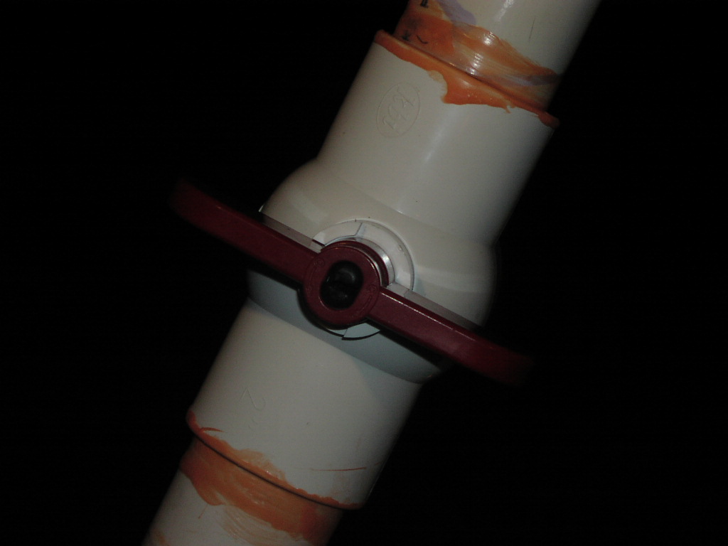

Ball Valve (trigger)
My Huge Spud Launcher

this thing is pretty sweet, how long is the three in segment. the 2in??

the 2 in segment is 4 ft long

Holy cow, that thing is monstrous. What's the red gunk all eover the fittings? Primer, or epoxy?

epoxy is the red,orange gunk that keeps it air tight when it is on the outside, it fills in any gaps.

the 3 inch segment is 3 ft long

You say that's primer and stuff that keeps the cannon air tight? Are you using this becuase you didn't correctelly use primer and cement on the cannon? If so I woulden't get ANYWHERE near that cannon it's just waiting to blow apart.

I did use primer and cement properly but just be extra safe i put some epoxy on the outside. Sorry I did not describe my previous post well enough.

Oh then your fine, I was worried :wink:

looks good, i'd replace the DWV reducer and tee though, and the schrader valve should be tapped thru 2 layers of PVC (where the fitting overlaps the pipe) all in all, good job, next you should try a homemade valve or a sprinkler
