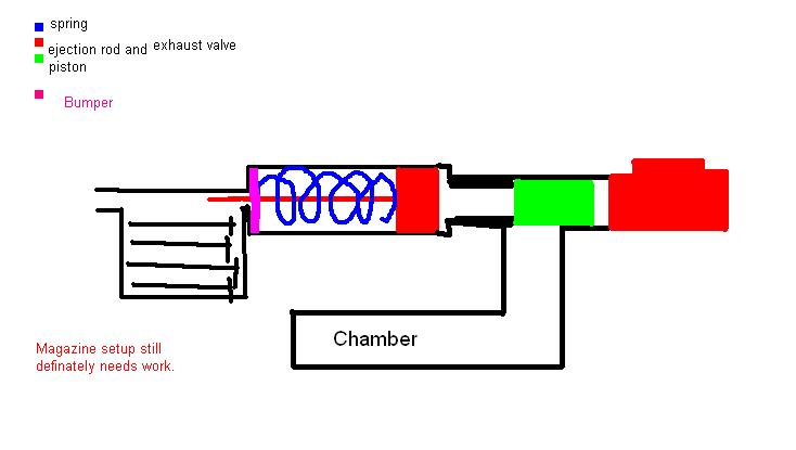

Edit: (again) This is a concept I came up with for the piston/nail striking part. Hope this helps...

EDIT: ammosmoke how thehell would that work.. when u pulled the blowguns the piston would comeback not go down..it would need reversed like a big coaxial with the barrel welded into the second chamber where that pin and psito nwould be located so when the first coaxial went off the air would go out the barrel and put the piston up in the second chamber alowing for the nail to get hit and pushed in..
btw that would be bulky as hell so im not doing it..

This design is by no means complete or perfected, but it's at least a start. The chamber and such could be shifted around so that it is more compact. At, say 300 psi, I think that it owuld drive a nail into concrete. Good luck! Hope you succeed!
Higher pressure = more force
- prototype.JPG (25.22 KiB) Viewed 4728 times
How would it work? Well, first off, this is only the part that strikes the nail, not the entire thing. There would be a nail clip below it that this setup would hit... If you look at a nailgun, the nails slide down spring loaded groove suspended by the head. When the nail reaches the end there is a hole large enough for the nail to go through head and all. The spring in the clip should be strong enough to keep the nail suspended by pressure.. And the spring would NOT push the piston back up, it is only to reset the piston position. It is weak enough, or should be, to be overcome by the pressure. Like a blowback gun, gosh. And it would not need a barrel.... maybe a half circle at the end of the clip at most. It would not be too bulky... this is basically what jacks posted above. This is pretty much how most of them work, but simpler. Ya, a blowgun prob isn't enough, it was just an example.
