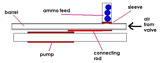

I was wondering if it is possible to have a pump-action reload like a shotgun in a spudgun cos it will look VERY cool.So far on this websites I have onl seen bolt-action and break-off reloads.And also, can anybody tell me why a shogun slug'sabot does not fly out of the barrell after it is shot, and why must a spudgun's sabot shoot out with the ammo?

The sleeve is suposed to be connected to the pump right? how can ypu do that wothout blocking the barrell?
Fri Jun 01, 2007 4:25 am
flamerz14 wrote:how can ypu do that wothout blocking the barrell?
What do mean blocking the barrel?

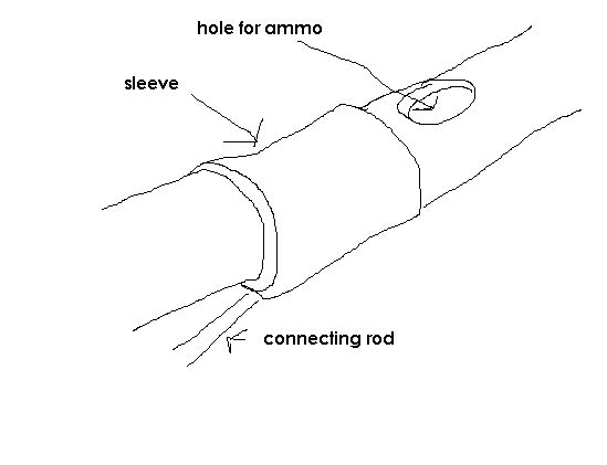

The connecting rod has totouch the bottom of the sleeve to let the ammo in , right? if you place a bar to connect them you most likely have to place in in through the barrell.
Fri Jun 01, 2007 4:42 am
dude... seriously.
the diagram is a cross section, this is what the sleeve looks like in 3D
(excuse the crap diagram, i'm at work and busy hehe)

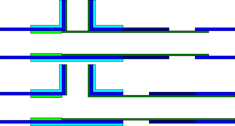

Here is my idea for spherical ammo, specifically golf balls. One of the obvious design differences is no holes in the barrel itself. I don't know if it even effects the performance that much, but that is why I made a different design to confront it.
<img src="http://www.spudfiles.com/uploader/uploadFiles/018.PNG">
2" Tee
2" Schedule 80
2" Schedule 80, glued to barrel acting as a grip
1.5" Schedule 40 acting as a stop (pretend this is light green)
1.5" SDR-21 (Class 200)
[I dicked up on the second part of the diagram. That being the lower portion of the barrel. Please ignore.]
